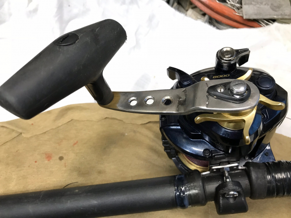

Here is the reel...It is obvious that has been converted to two speed operation when you see the spacer between the right side plate and the reel frame and the shift button on the handle locking nut.

Awesome tutorial, thanks a lot. I just picked up one of these in great condition with a rod for $100. The guys wife said he had too many rods and reels.
Do any later model shimano handles fit?
yockman
I don't know about other Shimano handles but I can certainly vouch for Alan's own product.
raumati01
I've got a bunch of Alans handles on my reels and they are great. Does he do one that fits this reel?
