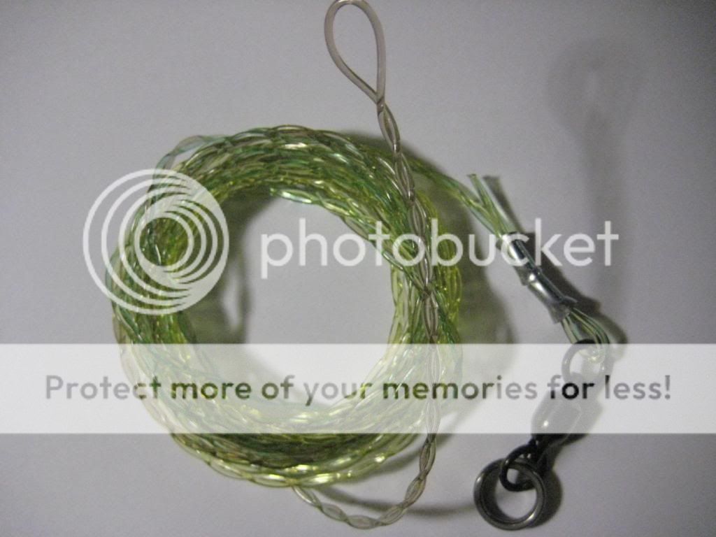

OldSchool
Here is a 100lb twisted leader of about 15ft, the loop end is joined via catspaw to bimini twist to the mainline with 250lb swivel crimped with  250lb split ring. Highly abrasive resistant, we use them for the big stuff that wants to pull you into around the reef and acts as a great shock leader for the big takes and allows you to wind right up to the reel with the leader.
Mandelstam
Quote from: OldSchool on March 28, 2014, 12:33:59 PM
I like it! Simplicity!
Thanks for the pic!
