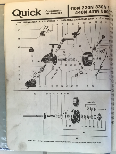

Where can I find a schematic for the 110n?

— Here is a schematic and parts list

This is my first day on the site and you are the lucky one to get my first request. I am not in the business of repairing reels for others, but I have several of my own that I am trying to get back into shape. I just bought 9 spinning reels. Most are Mitchell 300's and 308's with a 400 and a 410 thrown in. The odd one of the bunch is a D.A.M. 110N.  I have fallen in love with it, and have been doing some research and decided to take it apart, lube it and fish with it. I've succeed so far as to get the old dark grease out of it, and lube it is best as I could. Believe it or not the hardest thing to get back together is the handle. I can not get the stem tightened down enough to slip the little pin through the handle. Can you share with me a location that I can get a schematic diagram of the 110N that is legible so I can check to see if I have the parts in sequence? The fish are biting and I'm getting more frustrated by the minute.  Thanks in advance for any direction and wisdom.
happyhooker
Greetings, Fleminski, from Minnesota & glad you're with us on the site.
If you click on the schematic Fred posted earlier, it will appear in a form where you can enlarge it and see everything in great detail (at least, that is what happens for me using the Chromium browser.)

Guess I am not sure what kind of schematic you want, Flem? --
This thread has had over 101,000 looks -- and the factory schematic and parts list from  D.A.M. Quick is posted just above your initial post -- and again on page 6.  Frank indicated to you that all you needed to do was click on the photo to get a sharp picture of all of the parts and details.

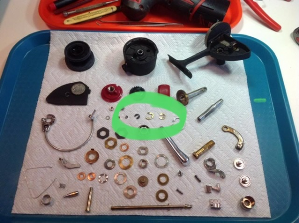

In the meantime -- the reel has (4) lock washers -- of which all are necessary -- for the reel to function without jamming up.
If you post a pic of the one you have left over -- I can tell you where it goes and the easiest and quickest method of attaching it without taking the entire reel apart.

Lookin at the enlarged view of the parts list, I see only 1 part termed "lock washer" for the 110-N, #100-069. However the diffrent part # that would show on the view of the disassembled reel may be listed, but hidden in the crease of of the folded over page. I do see some "C" clips(sometimes called "e" clips?) in Fred's photo, would those be called "lock washers"?

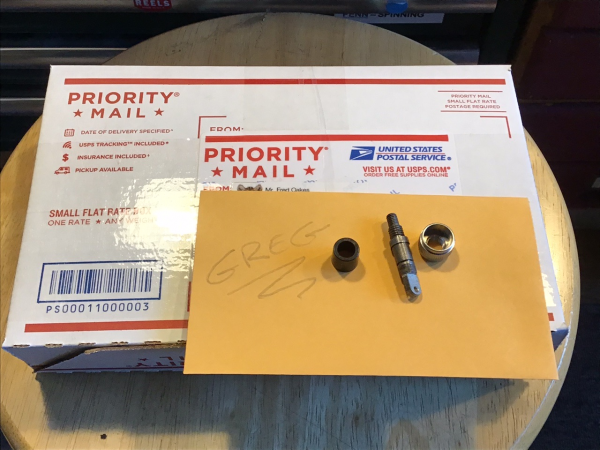

Hang in there, Greg —
We are fortunate to have these NOS parts available — on the way to you today.
Haven't been to the Post Office in a couple of weeks with everything going on here in California.  This has been sitting on my outgoing shelf for a couple of weeks.
I will slice open your Priority Box with the new Cardinal metal spool, and the A/R spring for the DQ 265 Microlite — and slip this in.  You should have it in a few days.
