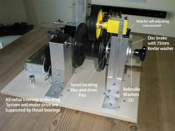

Hi Folks,
I have finally finished my line spooler "The Drag Queen"  :D:

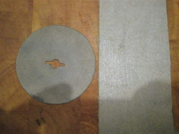

I had some interesting results comparing Kevlar and carbontex (both dry). They both produced similar drag characteristcs but for a given drag the Kevlar produced less heat  ???
Both materials were setup to provide 10lbs of drag (determined by a spring balance). I then ran down a freshly charged battery on my portable drill - Kevlar 9 degrees C cooler  ??? (measured at the same point adjacent to the drag disc).
Measuring the drag (with both materials) before and after showed similar fade characteristics, Kevlar 2% Carbontex 3.5% nothing in it! Comfortable (for the drive chain and reel mount) max drag 20lbs. I re-spooled with braid several times to check if the extra drag would allow for more line (ie tighter packing) but found that anything above 10lbs was a waste of time - I'm guessing that the minimal stretch of braid is removed by 10lbs, so 20lbs makes no difference. I am definitely open to suggestions on that one :D
One weired thing that did show up - I slapped a cf washer between the Kevlar and disc plate - it worked fine. But when I removed the CF the kevlar (on its own) had drastically reduced drag for a given pressure  ??? ??? I tried cleaning the kevlar with IPA but no go, I had to replace it :( I haven't got a clue what was happening there.
I tried several method of gearing down the motor to achive more torque. I finally settled on toothed timing belts and pulleys to give a ratio of 12.5:1. The final drive speed to the reel is 3 revs a second (180 rpm). Re-spooling my Okuma Andros (with the original braid), on this jig, has left a a gap of 3/16 to the edge of the spool (1/8 more than the previous spooling attempt  :o). I'm gonna have to get some more braid now and re-spool the rest of my collection :D

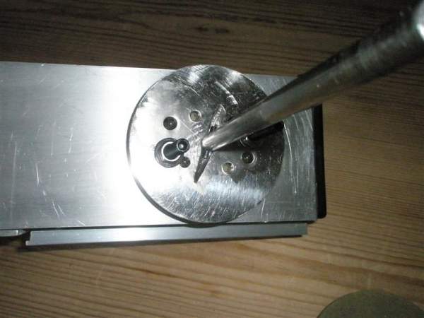

Wow!  Quite impressive!  I like the use of the belt-driven ebike motor for power, the spool attachment method, and the design of your drag system.  Any chance we could see any preassembly pics of the drag system?  I foot pedal on/off and/or speed control switch might be handy, since it is often useful to have both hands available while spooling/stripping line. You could go into business selling this beast.
