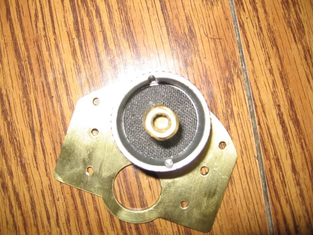

Hey does it matter if I use the original washer under the main gear with the new stack? Here is a pic of the drag stack. I feel like the original was a little thicker.

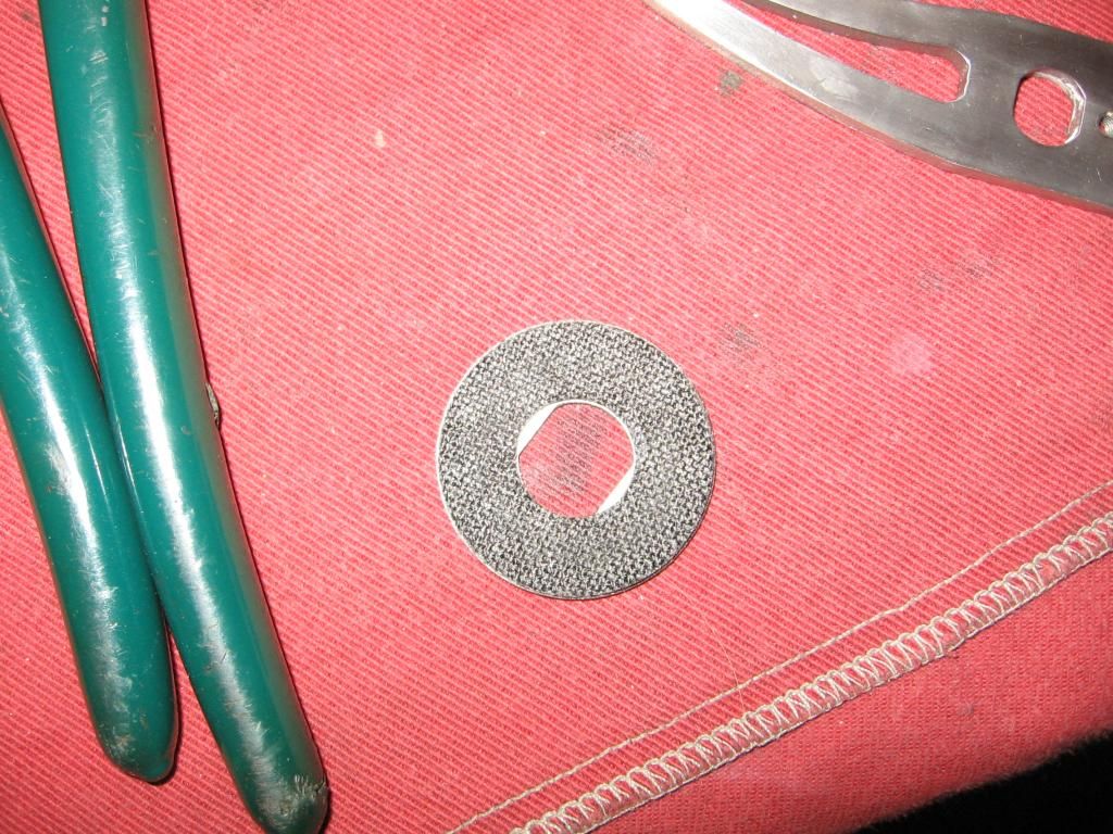

Also, if you look at the second picture you can see how there is a gap between the carbon fiber washer and the edge of the main gear. Is that normal?
One more thing, do you put a little grease on the end of the gear sleeve to allow the star to move freely?
#7
Sean,
As long as the under gear washer is in good shape, you can reuse it. I usually find that they are brittle and crack trying to remove them. Delrin is ideal here.
I usually get Cal's all over the end of the sleeve putting in the drags, so that is good enough for lubing the end for the star. I never really noticed the gap that the carbon fiber leaves in between the gear and on the outside of the metals. I guess it is normal. More reason to roll your own. ;)
