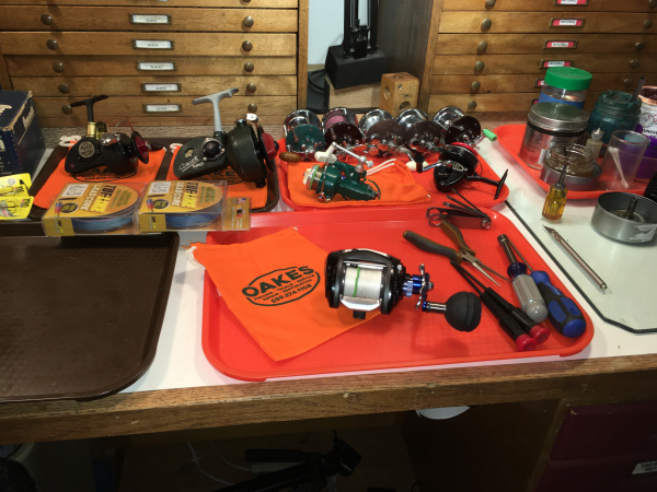

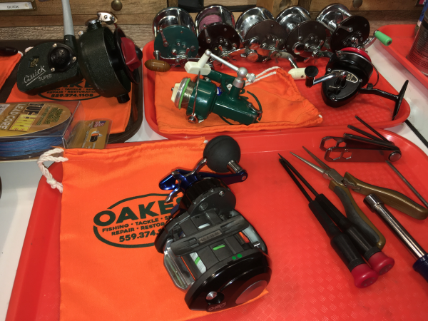

Thank You for the great and complete service tutorial on this, John!
I have done a few pre-fish services on new ones — but this afternoon needed to do a complete on a "60" size NaCl that had been fished in the salt — and your step by step, as well as personal observations about greasing, drags, and bearings were spot on.
This is the first one I have taken all of the way down.  There were a couple of places where even an experienced guy might have made a mistake that would break something expensive.  But no worries with your excellent tutorial.
