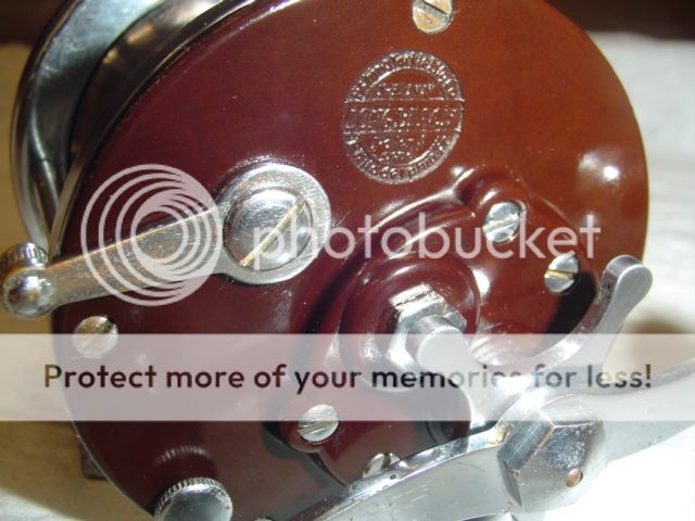

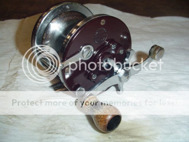

Yes, there is a Long Beach take apart. Two are known to exist, I believe they are prototypes for the Penn Coronado.
Looking at one is a study in confusion. If you are familiar with the 1933 Long Beach, then you know it is a three cross bar reel. The 1933 Long Beach is used to create this prototype, so the cross bar holes had to be plugged on the tail plate and used as a mounting ring fastener on the head plate. The holes were added to the side plates in order to convert a three post reel to a four post reel.
                I believe Penn created this Hybrid Long Beach / Coronado to provide a few West Coast salesmen with examples to show their heavy West Coast commercial buyers. I do not believe this reel was ever made for the public.

QuoteThat Long Beach is nice shape on the outside, but will need the Alan Tani treatment on the inside before you can fish with it for some L.I. sound porgy
I know it looks dirty on the inside. That's my fault. When I restore a reel of that importance, I take before and after photos. The outside shots are from the group of after photos and the shot of the internals is from the before photo group.
Here are some of the internals during the clean up and finally assembled:
This is over 80 years old and all the parts are original with original finishes. When I do a reel like this, my criteria is to simply clean it and get it operating as it should. Maintaining its original parts, even if they do not look perfect, if very important to me.
