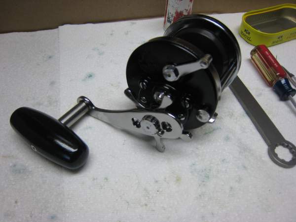

I'm back!!!!  Finally able to get the needed parts for the Surfmaster 100, after traveling to NYC to visit our Beautiful Granddaughter!!!
Dominick tells me I was one block away from Broadway Dom (the corner of Spring St. & Broadway).
Anywho, back to my project...
Did most of the upgrades, still need to obtain a Delrin washer from Dawn & a steel main gear, but for now, the reel is highly fishable.

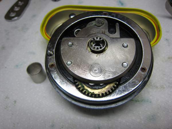

AND BTW  Who was the Penn Mensa Student who decided to use a copper strip for a dog spring???  Getting this piece into the right side plate left me in a ball of sweat (and it's 52 degrees in my garage) and off the chart blood pressure!!!  Followed instructions from this posting:
           http://alantani.com/index.php?topic=2101.15
Finally got it installed...
But finally, DONE, DONE and DONE!!!!
And I think this will be my new Rockfish & Lingcod reel, and retire my Daiwa Sealine 27H to "Buddy Reel" status!!!!!

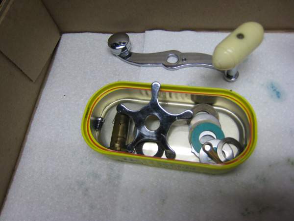

Per usual, like when I change a spark plug on a lawnmower, I have a small box of leftover parts!!!!
Same issue here, anyone want these leftover parts????

You forgot one more part. It is my custom sleeve spacer.

Good Work Wayne! ;D
She is Beautiful!
You think that little brass spring is tough. The little 99 coiled spring is a real treat if you don't have the knack.

Here's a youtube video from Scott's that shows a slightly different approach to getting the surfmaster dog spring back in without losing your mind.  I found it useful.
