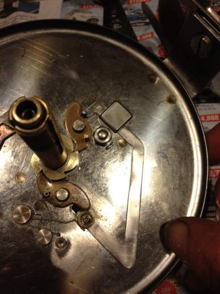

I spent a fair bit of time just looking at where I was going to place the extra dog which Wallace has sent me. In this photo, the ratchet is on the left (triangular piece) and this operates on a plastic wheel which presses onto the underside of the spool, and can be removed. It sits slightly higher than the A/R dogs. There is a "tygaflor" washer that separates the ratchet and A/R wheels. There is a lever on the reverse side of this backing plate which slides the A/R trip bush to lift the dog off the A/R wheel. This allows the spool to spin freely backwards should you wish to feed a live bait to a fish, or run a lure out behind a boat etc etc, without turning the whole spool to the casting position. Just watch your fingers on the crank knob! I will get more pics of the assembled reel later.

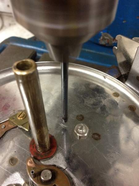

Fine tuned the position on the dog post, centre pop the location and drill.
I was limited to where I could position this post. There is a flatbar frame support which you can see on the reverse side of the backing plate. It's 3mm thick. I wanted the post to pass through this  flatbar for strength. The hole drilled is 4mm.

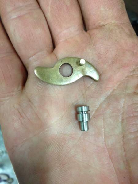

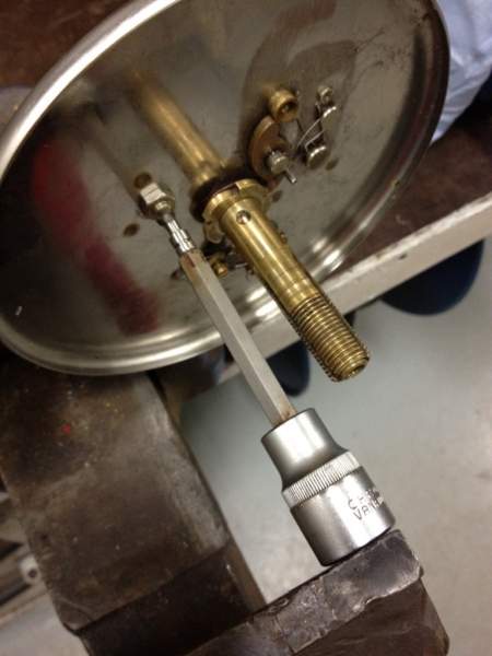

Machined up a post. The spigot going into the  flatbar was a slightly over sized for a press fit.
Line up post.....
Then drive it home pressing it in with a dolly and a bench vice

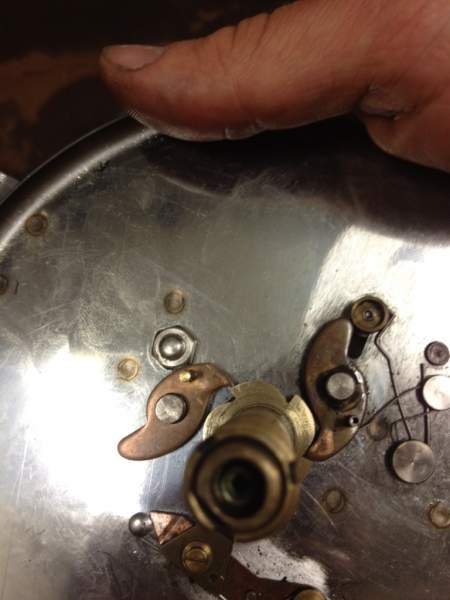

Now rough mark where I need to file the extra dog back to, to get them to drop in synchronized. The dog just clears the nut with plenty of clearance over the A/R wheel, so it will still allow free spool.
Begin filing the new dog to shape
Take it easy, with frequent checks between filing strokes until both dogs drop in together.

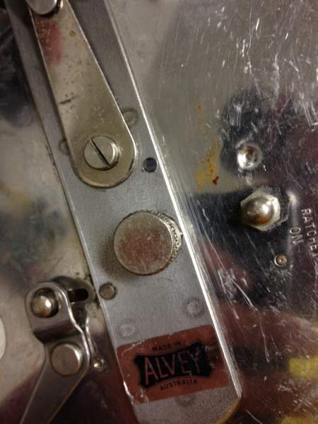

Now I wanted to maintain the reel's ability to Freespool. I've started on making a joining piece that will connect the dog lifting bush with the ability to lift the new dog. I've had to remake the slider piece that  the lever
acts on to move this bush, out of stainless. The original chromed brass one was not going to work for me and I had to drill it out. I will be able to re-use the brass bush though.

Got the dog trip mechanism finished today. Still have one more post to make and press in for the extra dog spring. Wallace,  I will be beefing up the spring wire a little to make for more positive engagement for the dogs, the original one does not always drop in with the wire provided.
 The slide piece was made from 0.8mm stainless sheet. The guide from 3mm flat bar, with a carefully filed slot to keep the slide on track. There is no slack at all. The little tab has a hole to take one end of the new dog's spring.
I re-used the brass piece that trips the original dog, you can see I have left a little length in the new stainless
slider post. I will eventually drill down a little further and dremel the excess off, and give it a tap with a punch to flare the end to lock the brass piece in place.
Dogs engaged
Dogs tripped
The slider lever.
Had to carefully pry the end of the lever up high enough to clear the slider post to be able to swap them out. The backing plate buckled a little, but I was able to carefully level it all back out.
