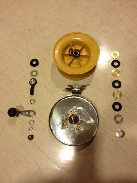

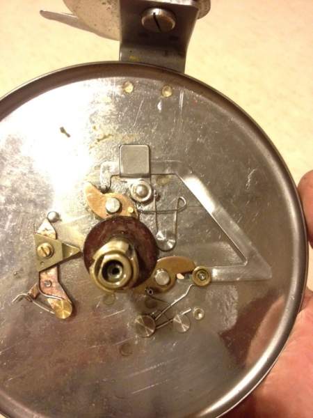

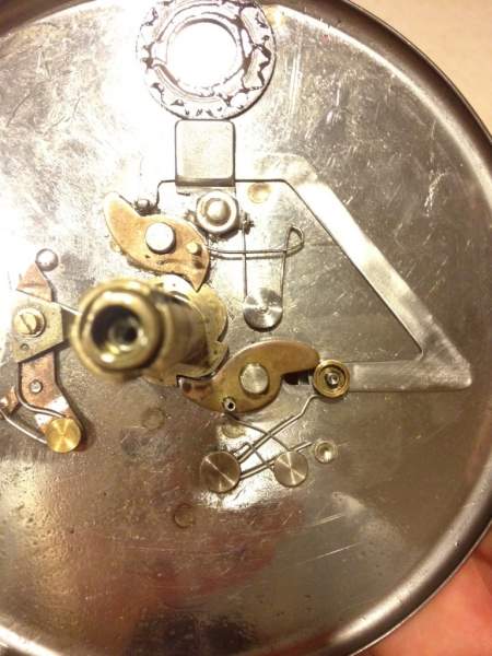

The extra dog mods are now done. You can see I have added another post to hold in the dog spring. The spring had to be shaped that way in order to remove some side thrust which was causing the new dog to hang up after it was dis-engaged. It now slips nicely.
The so-called Tygafor washer over the top before placing the spool back on
The rest of the parts laid out. Wallace this gave plenty of drag, and after greasing the carbons with Cals, it's actually quite smooth. Can't give you numbers, I've got no scales at work. I also suggest you keep the thin white washer between the drag lever, and the drag stack cover. Without it, if the spool spins backwards on the drag, it rotates the lever backwards, and reduces the drag pressure.

put a few hours work into the reel last night.
from right/ delrin ratchet(standard) delrin washer(me)lever drag,nut,handle,nut, belleville,screw cap
i had 2 belleville washers,to take up the slack,but when i rebuilt the drag there was no need for the 2nd belleville
which is good,they only act as spacers,dont effect the drag
new v8 sportscar,what can it do.i stopped ar 44lb in straight pull.
so back to fishing,i set the reel at 20lb,26lb at full,perfect.
this is the 20lb setting,can you see the red dot.by taking the handle off and moving
it around to the dot,push the lever,44lb!
i also put the tygaflor washer back into the stack to see how it stands up against the c/f
i can set the drag at 1lb,5,10,15,20,25 or free spool.
its fishable now,but still a lot of improvement left
new handle,knob,ss washers,rod,delrin under the stack,.05 c/f washers etc;
the drag is very smooth,dogs work perfectly,thanks chris ;)
