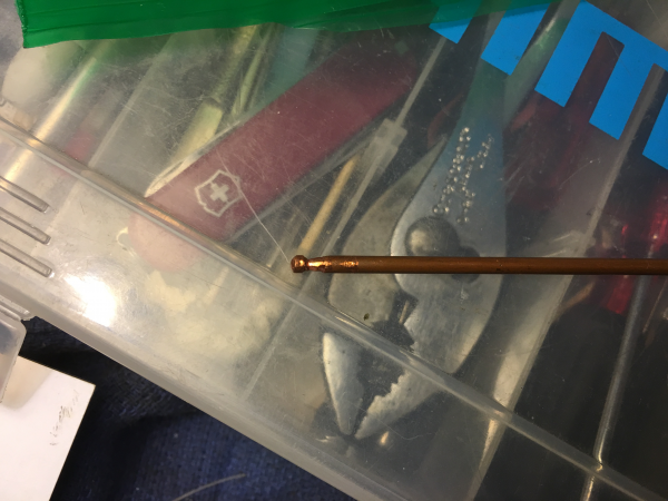

This seems like a good time to introduce one of my hacks. What we are going to do is make a rudimentary slide hammer to aid in bearing removal. All you need is a thick piece of coat hanger material and a file and a few minutes of your time. File a knob onto the end and bend some kind of a stop on the other end. Then all you need is a pair of pliers or adjustable wrench to use as your slide hammer. Works on all except the toughest of bearings, oh, just tilt it side to side as you tap the wrench up. Mine ended up around nine inches long. "Hamachi hacks". One more thing, take the bearing cup out of the plastic or graphite side plate to avoid cracking it on stubborn bearings, anchor the cup in a soft jawed vise.
Looks great!
I do have a set of bearing pullers that work on 90% of bearings but sometimes you need a trick like this.
It's funny how being away from the shop a few years lets one forget everything they ever learned...well...at least I have! :D I've been prying on a Mag 10 spool bearing for 2 weeks with no success. Seeing Hamachi's hack reminded me I could pull and twist on this little bearing for the next 5 years and prolly still never get it out of the cap without some "impact". I merely put the cap in the vise...clamped vise grips on my "puller"(fashioned from a nail)...and tapped the vice grips with a hammer. POP! Sheesh...::)
