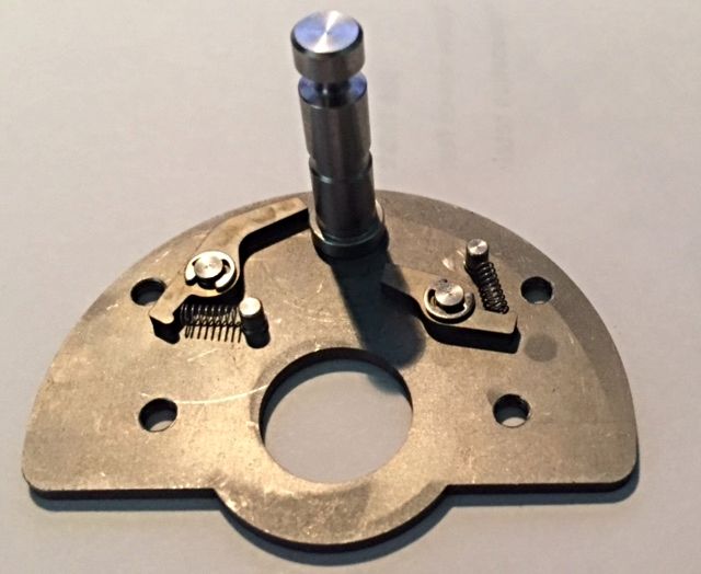

I don't see why :-\, some might say that this bridge is better
http://i1280.photobucket.com/albums/a494/prochallenger/FullSizeRender_1_zpsf13a6ec6.jpg?t=1418761539
compared to theirs
https://www.mysticparts.com/Assets/images/pennparts/parts/3_113hn.jpg
I agree Sal (*previously refered to as "Lee") like the SS and double dogs, but I like the Baja gear set, and under gear bearing.  Looks like minor mods to the SS bridge might allow for the use of the stainless baja set w/undergear bearing?
