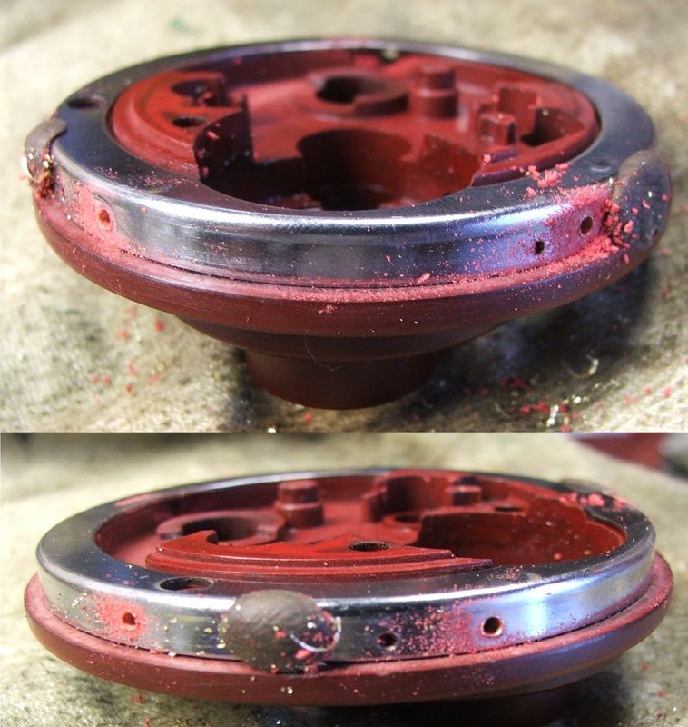

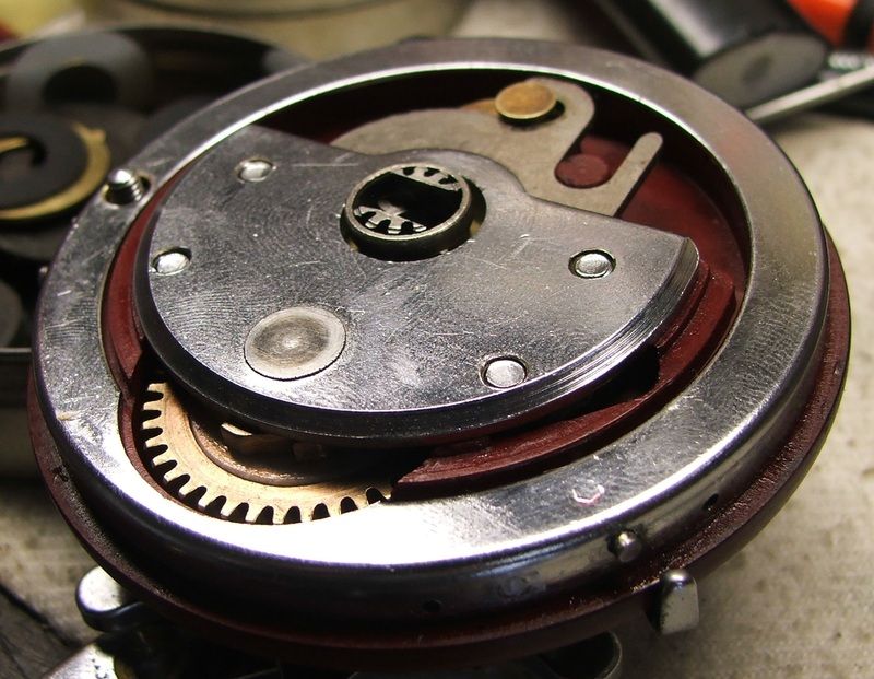

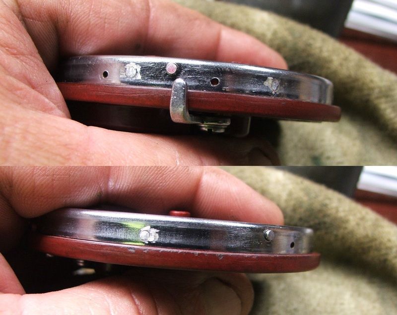

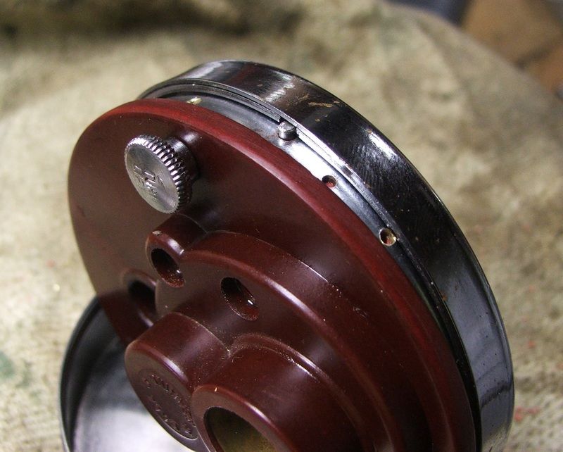

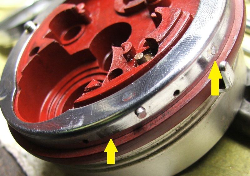

Hi guys - I had a scrounge through one of my spare parts box's and had a few Squidder tail and head plates and one red head plate was just about mint apart from the chrome ring - It had been pushed out slightly where the bottom edge of the chrome meets the plate - the ring had three cracks below each of the locking pins - The plate had swelled out that much I couldn't get it into the outer ring of the frame let alone turn it .

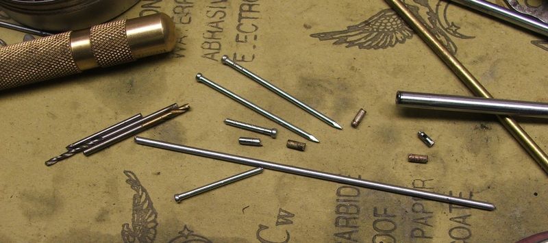

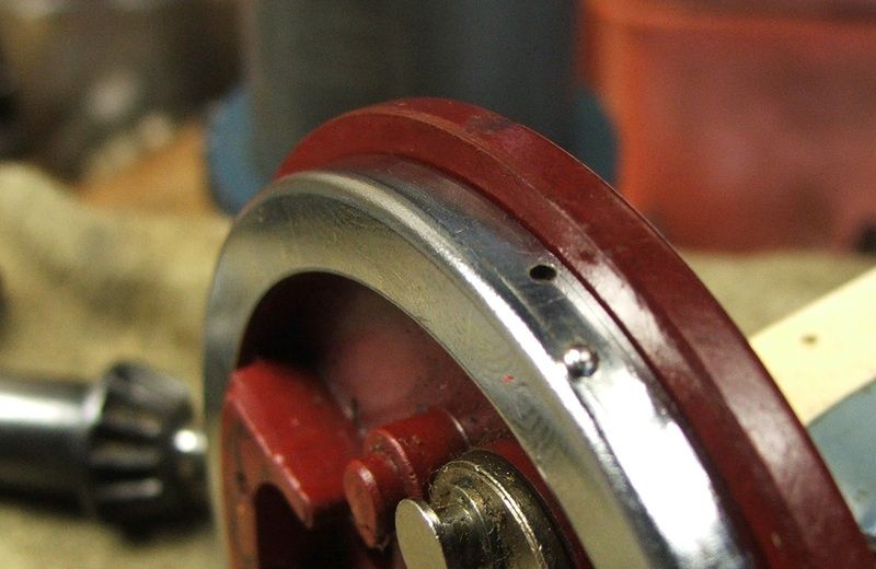

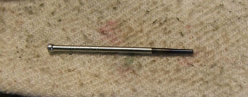

Ring removal = had to make a small punch out of a steel nail - used a file with the nail in the drill press and case hardened the end in kasenit - Some tool steel for the main locking pins X3 and the ring pins made out of steel nails slightly thicker than the original pins X6. Only had to give these little pins X4 a wee tap just enough to clear the chrome inside edge .

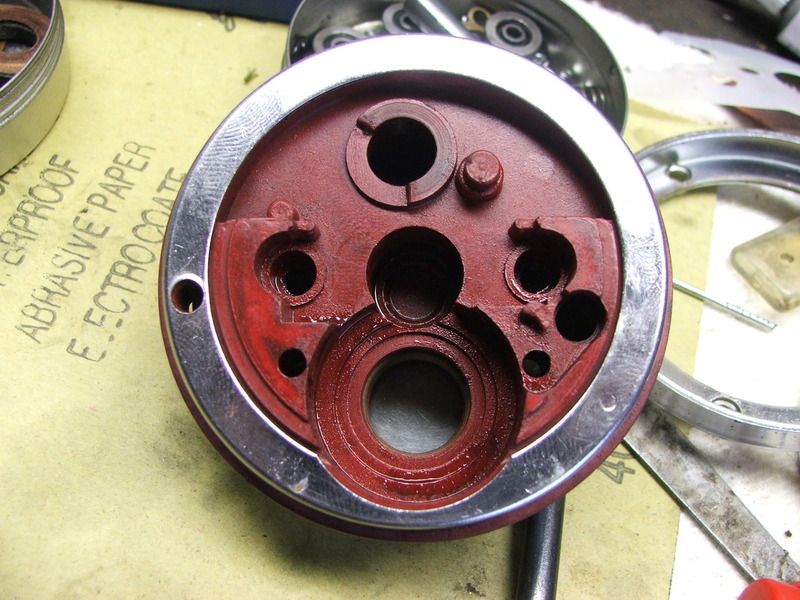

The ring fell out easy and got the good ring out off another head plate that had a stuffed bearing housing .See pics.
And the cracks by the locking pins .
The pin punch

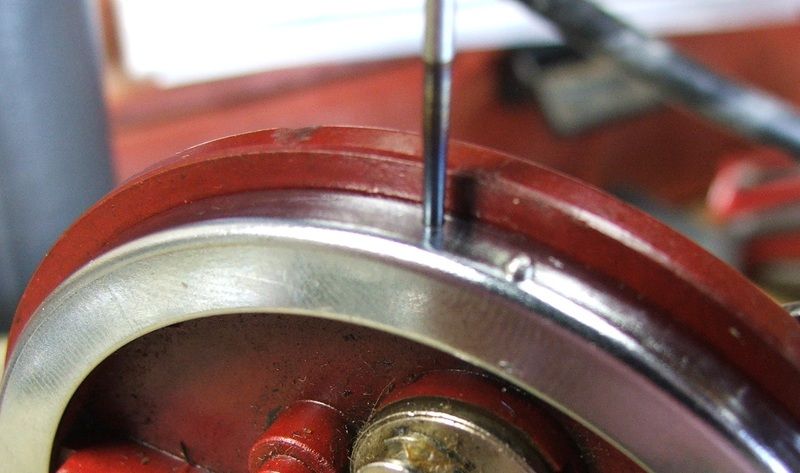

Getting ready to punch the pins in.
All done.

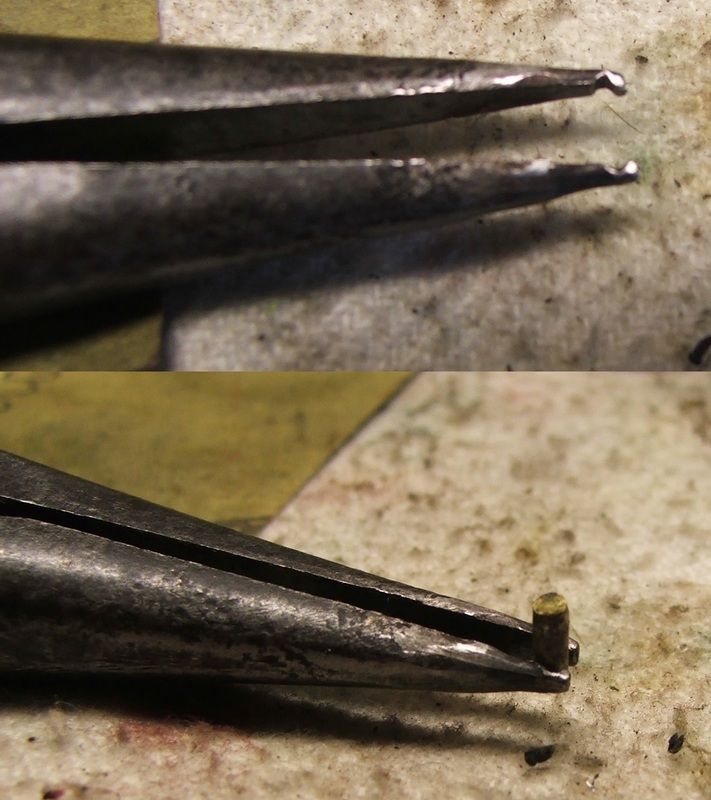

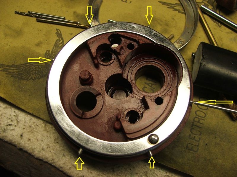

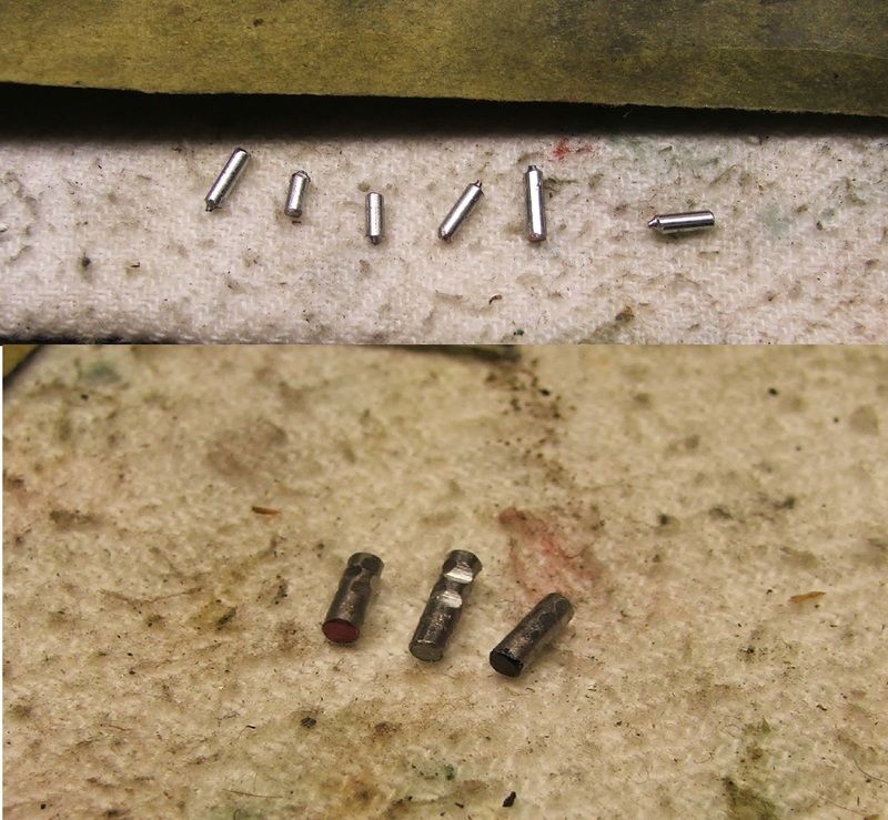

Back to the Squidder - Tool I reshaped to remove the main locking pins and heated pins with a soldering iron for about 4-5 seconds - griped pin with tool and twist and pull -They came out easy also. And the replacement ring .
Replacement pins.

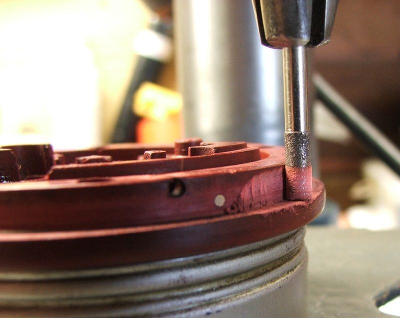

Turning the plate edge so its square in the drill press.

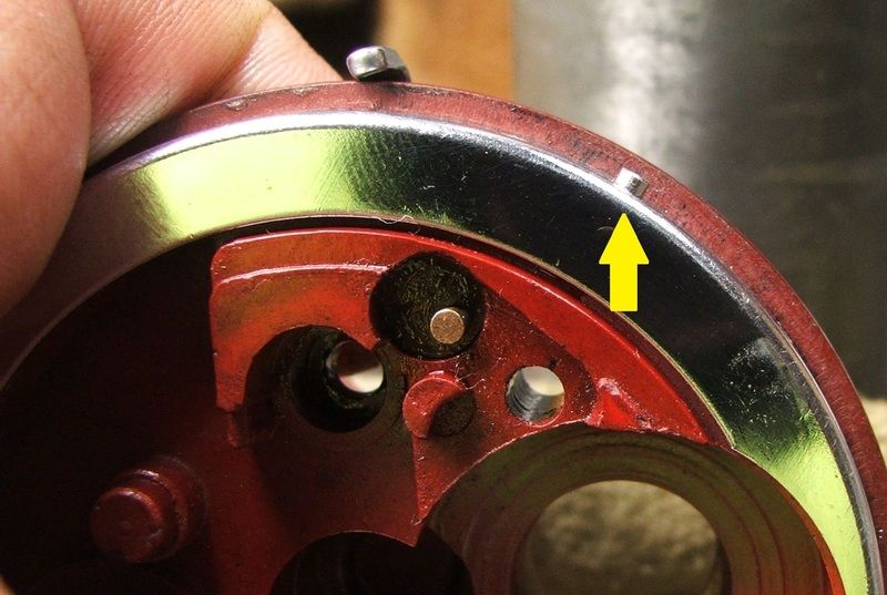

Now for the small pins X6.
Ground pins down flush with the ring.
