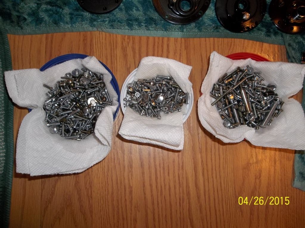

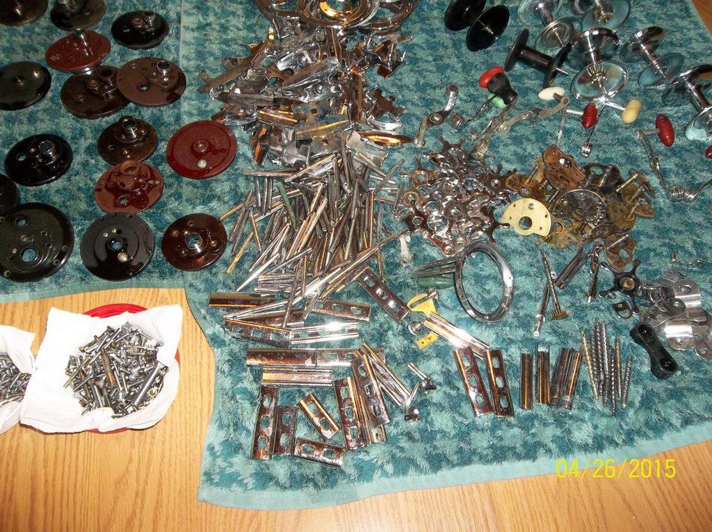

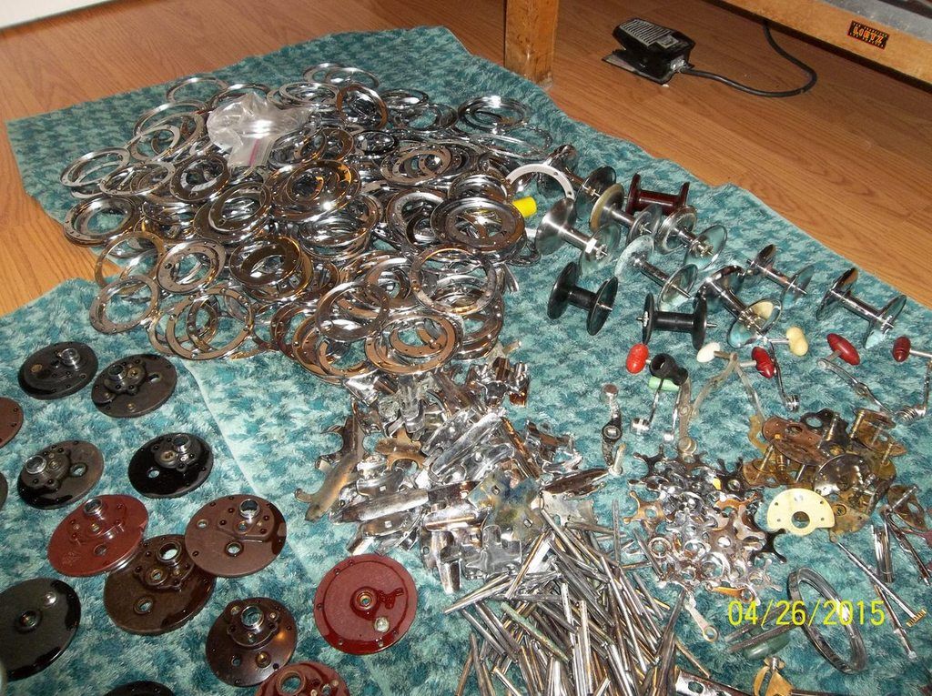

If I did not have a good and powerful Ultrasonic Cleaner -- I would not work on reels -- I do not like to scrub greasy parts that much.

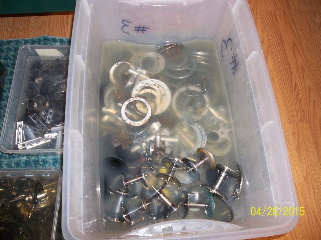

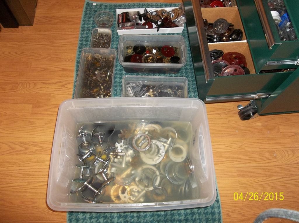

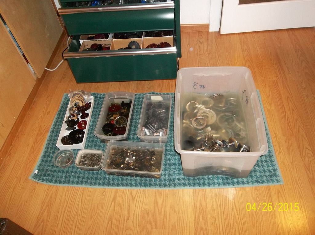

Disassembled all of the reels yesterday morning -- separated parts into groups that would go into either Purple Degreaser or Simple Green.
Then started to do 3 or 4 pounds at a time with double and triple separate vats all going at the same time.
Rinsed each group off afterwards with fresh water -- then just dropped them in water overnight until I could get to them today.
This was not that difficult -- as a matter of fact -- I was able to cut 1 and 1/2 acres of brush and weeds on our property in between switching out containers and parts every 30 minutes.  Used a DR Trimmer Mower plus a weed eater for the places the DR could not get into.

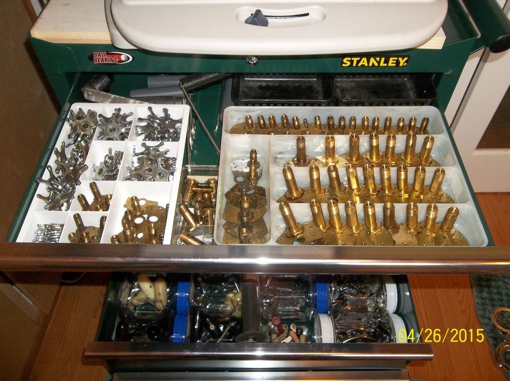

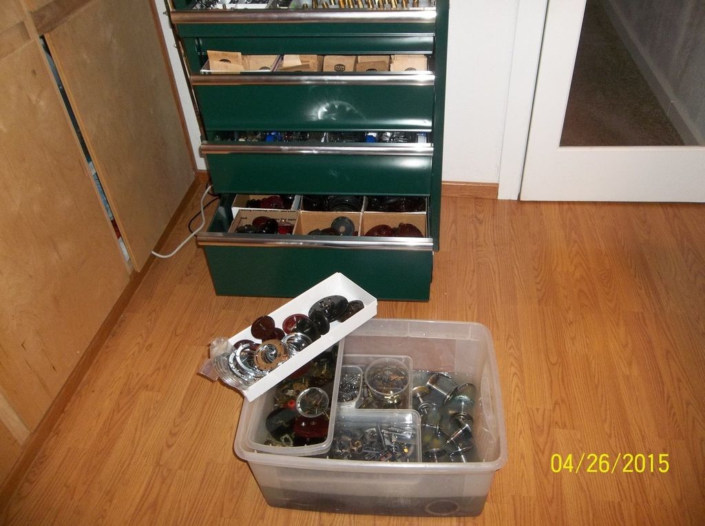

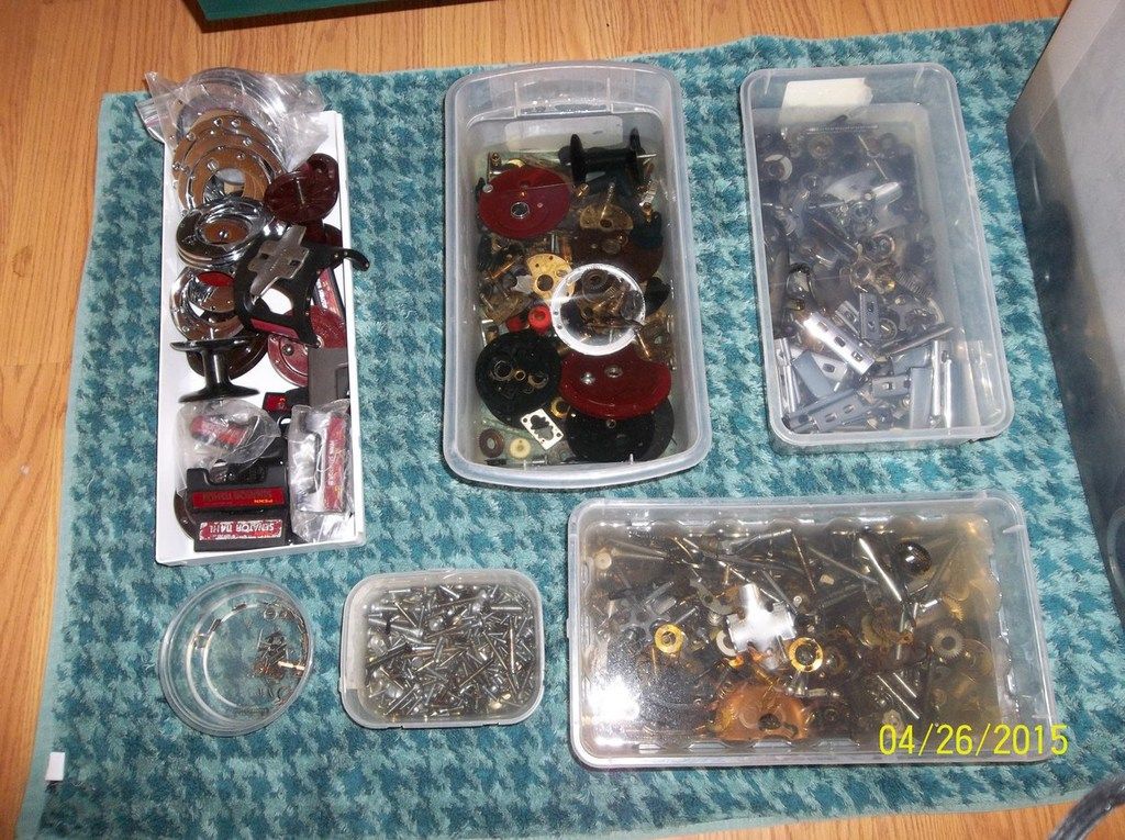

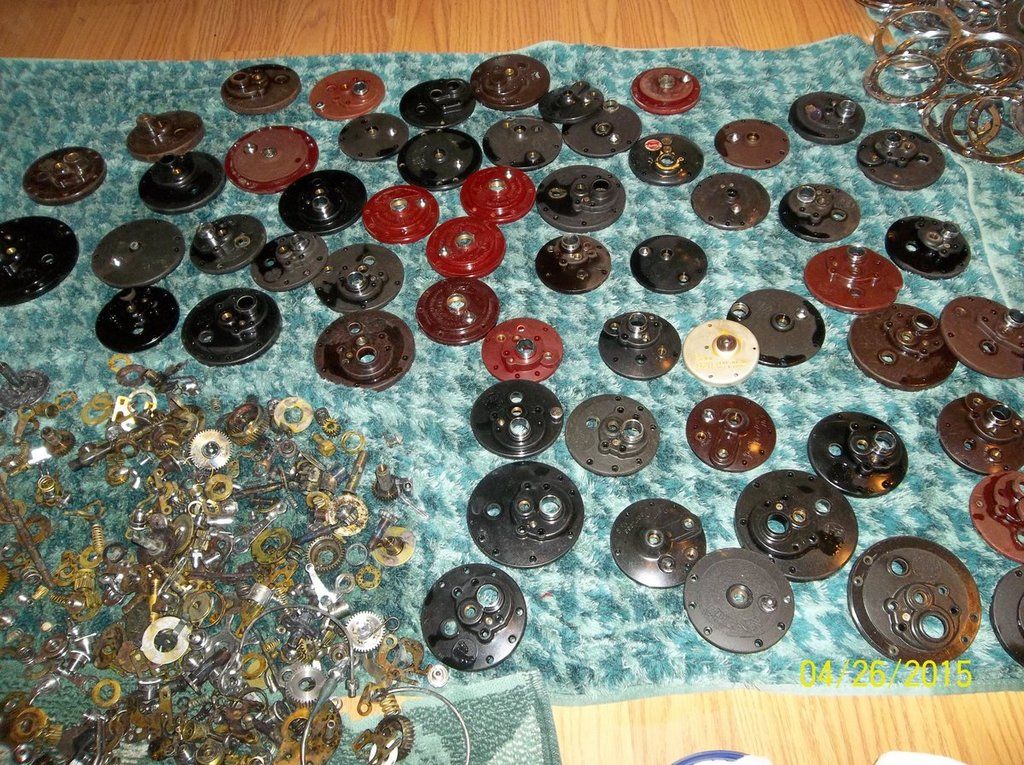

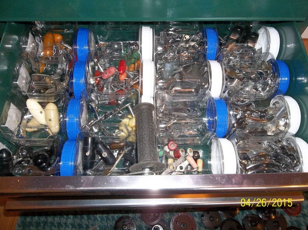

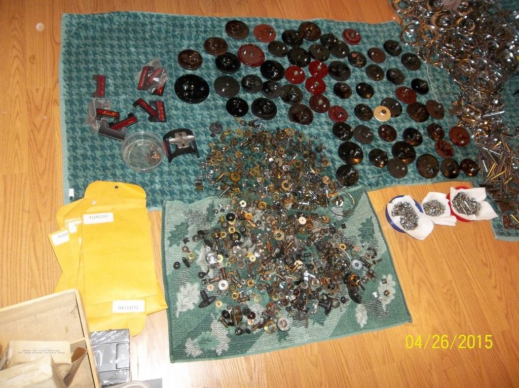

So this morning I basically separated all of the parts into basic groups to dry -- then they will be put away with the other Penn parts I did last week.
Rings will be separated into the same part numbers -- then put into plastic ziplocks -- marked for use.
Sideplates are easy enough to recognize -- the rest of the parts will just be lumped together in Penn key number sequence -- but not separated by reel number.
Since everything has a place waiting -- it should only take 2 or 3 hours to sort these into their proper places.
A dirty job done -- and not that tough.
Was able to salvage quite a few parts out of just a bunch of old skeletons & loose pieces.
