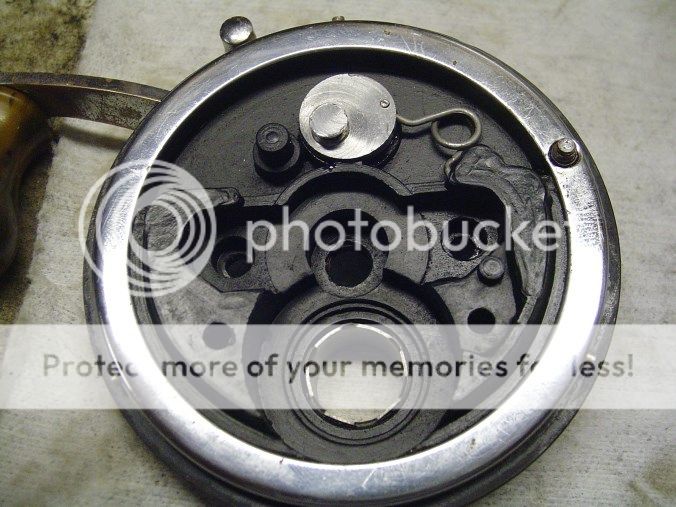

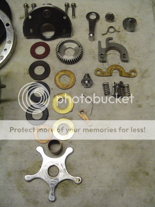

I go home and strip the reel down. Every piece on this old Model 97 was original. These first models are interesting because so many of their parts are vintage materials as well as vintage parts. Internal parts may be German Silver or chrome plated brass. Their level of quality is not done in later reels.

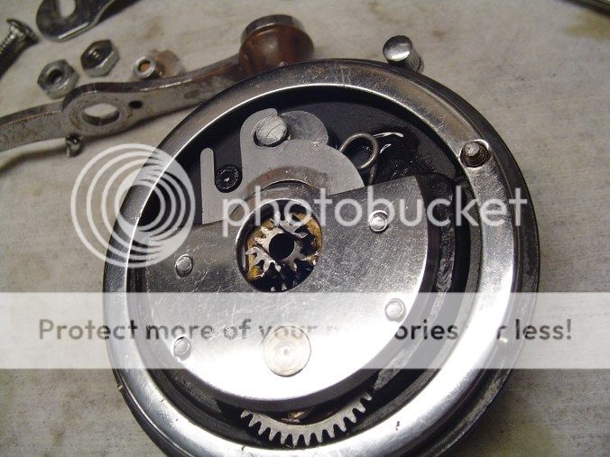

Main and pinion gear on this first gen Silver Beach are steel, not stainless steel; but tool steel and they are strong. The gears in this reel are from 1938 and there is not a hint of corrosion. The drags are in good shape and are made from leather. Normally I would upgrade them; but, this reel will be a shelfie, so I want the drags to be original for correctness sake. If the next owner want to fish the reel, he can change them.
                 The jack, eccentric cam and bridge plate are either chrome plated brass or German Silver. I am not sure which.

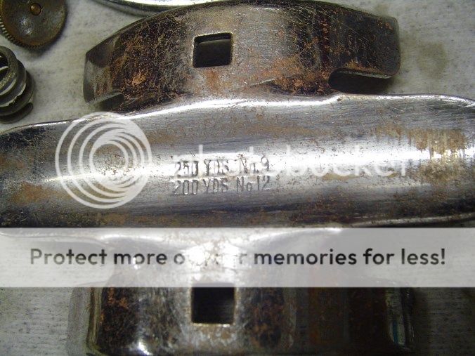

The bottom of the stand is a big vintage give away. Very few Penn models use a stand that is ID stamped like the old Model 97 and Model 98.

Only the yoke is plain brass in these early models.

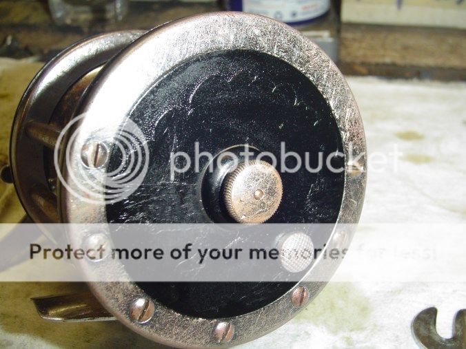

The star wheel edges are sharper on the old models and the star wheel is undercut to allow it to fit over the plate bushing, giving a better protection against foreign objects or water from entering the reel.

Picture tail plate plus a waffle cut clicker screams late 1930's.
Fully assembled, 75 years old and it still operates smooth as silk.

Nice find/save Mike! I'm glad you addressed the I.D. stamping because I've always wondered which models came with this stamping. I've got a few and was curious if this was indicative of the year the reel was made or something they did for certain reels over the years.  I've never seen the stamping on any Post-War reels.

I do not believe the eccentric is Stainless Steel. I suspect chrome plated brass or German Silver. According to the 1938 catalog, the early reels had German Silver frames. I have seen many early Penn German Silver spools also.
This reel has been very used and used hard. I think it was cared for every year; but, I know it was not babied. It was a mess when I got it. After I took it apart, I was sorry I did not take a BEFORE picture. I did not expect to find the internals as original as they were. I guess all the dirt and grease protected it.

QuoteNice find/save Mike! I'm glad you addressed the I.D. stamping because I've always wondered which models came with this stamping. I've got a few and was curious if this was indicative of the year the reel was made or something they did for certain reels over the years.  I've never seen the stamping on any Post-War reels.
The ID stamping can be a point of confusion for many collectors. The Silver Beach 98 and 97 was made from 1938 to 1942 and they both had the logo I posted. Neither the logo or the Model 98 returned after the war. When the Silver Beach model returned, it returned as the Model 99 aka pre-war Model 97. Penn brought the Model 99 back in 1949. The years of 1946, 47 and 48 saw no production at all for the Silver Beach model.

   I also have a silver beach with the ID stamping, however, it has the torpedo knob.  Do you know which models came with the stamping?... I have a 249, 165, and the silver beach with the bottom stamping.
Thanks again,
QuoteI also have a silver beach with the ID stamping, however, it has the torpedo knob.  Do you know which models came with the stamping?... I have a 249, 165, and the silver beach with the bottom stamping.
Thanks again,
As far as I know, only the Silver Beach came with the double stamping. The 249 and 49 should read ""200 Yds No 15"", the 165 and 170 should read "150 Yds No 9""

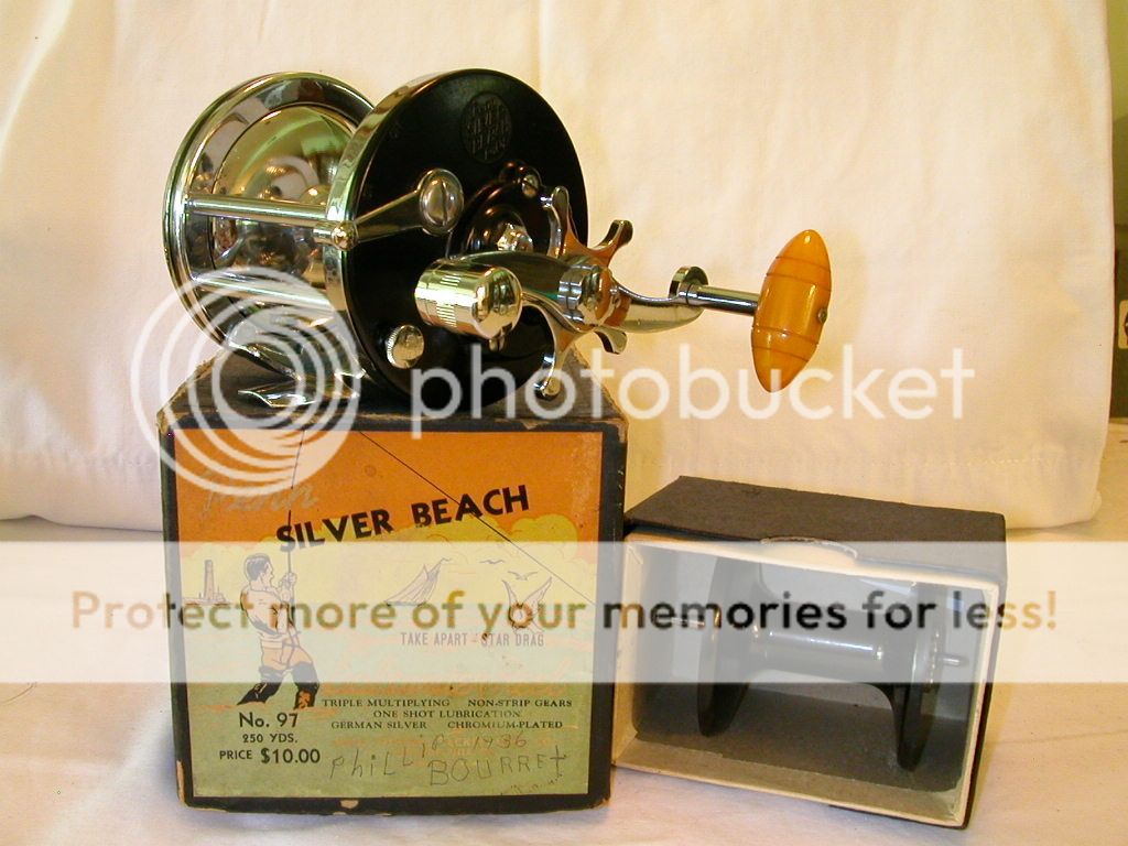

Here is one that has been in my collection for many years. I don't think I have seen too many like this.
You are correct, Mike... My silver beach is the only one with the double stamping.
Your silver beach is in some impeccably mint condition, and I agree with sal... That handle is darn sexy!
I noticed the box says 1936... Would that be correct for the year of that silver beach? ...can't be far off, but I didn't think the torpedo handles were out yet.
Thanks for the drool-worthy photo,
#12
QuoteI noticed the box says 1936... Would that be correct for the year of that silver beach? ...can't be far off, but I didn't think the torpedo handles were out yet.
The person that wrote that info on the front of the box label was not me or the previous owner. I knew the previous owner, he became ill and sold me the reel. He is no longer with us. So, to answer your question, the info is more than likely incorrect. The first year of the Silver Beach is 1938.
This box and reel combination, in this condition is rare. Even though the information scribed onto the box label is wrong, I would never try to remove it for fear of damaging the label. My estimation of the age of this particular reel is 1941 or 42. No real way of pinning down a exact year because the price on the box was the price of this model from 1938 to 1942. I do not believe the handle knob color indicates a 1939 torpedo. I feel 1939 torpedo handles were all a dark colored knobs and the 1938 models did not use a Torpedo handle at all. So, this is not a 1930's reel; but, it is very close. This handle knob color probably dates the reel closer to the beginning of the war.
QuoteBeautiful reel...love that handle
Me Too! The color on this handle is not usually seen on the early handle blades with the tall counterweight. Maybe it is so dramatic because the reel is NOS; but, I believe it is an odd handle combination.
Good point about the year being incorrect unless you got the only silver beach made in '36😉
My silver beach has a very dark green handle, however, it's not even close to the condition of yours. Wow, 1940's NOS penn reels are tough to come by now a days and even tougher with the box. The seller of that boxed silver beach is smiling now knowing that babies in good hands.
Thanks for the explanation,
