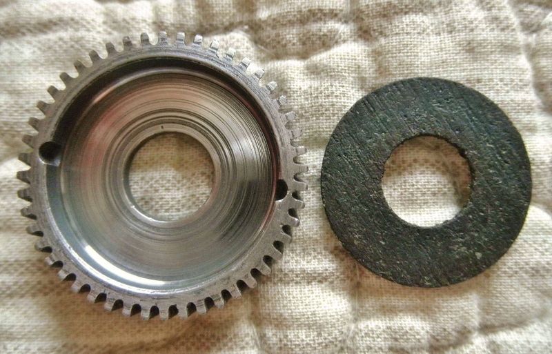

Hello everyone - great site here with tons of information.  I've been wanting to upgrade a Squidder to be a solid OBX reel for weight and bait chasing red drum and the occasional ray/shark that might come through.  It's for surf casting and distance is important so I went the direction of the Squidder instead of a Jigmaster or something bigger.  I'm noticing that almost everything is focused on the big game reels or the Jigmaster though.
Of parts that are still available, here are my thoughts:
Tiburon Frame
Drag Upgrade
SS Spacer/Sleeve
Mags
Is that about it in terms of what's available right now?  I don't see the SS bridges, faster/stronger gears, etc. available for the Squidder.  Is there anything else I could do to turn my old gal in to the queen of the ballroom on the sand?  ;)

I haven't seen a steel bridge for a squidder, tho I believe you can install a SS gear sleeve. the Squidder is a bit slow, 3.3 to 1 as I recall. The topic of faster gears has been discussed in its forum previously and I think it is what is due to the size of the gear well in the side plate: no room for a larger main. However, feel free to search that thread; its been a while since I read it.
If your reel has the spool with fins in the bell, I'm not sure you have room to mag it out. That said, the reel was tuned for decades using STP mixed with a lower viscosity oil to get it where you want it. I have four and break them out now and again as they were a staple for 70 years....well documented in Mike's book "Penn Chronology".
my .02: first upgrade is carbon drags and better handle, then maybe frame, then sleeve, and let 'er roll.
Rancanfish
All my Squidders and Surfmasters have an original plain steel gear. You can still get them on Ebay occasionally. (Penn #5-60). Make sure it's not brass. I also get the chrome over brass bridges for looks.  8)
I think if you add the frame and sleeve you are good to go.  If you want more drag you can contact Bryan Young and get the 5 stack drags set up. You are then into the 'adds' a bit over a hundred bux.
I'm not a fan of magging reels.  If you want a good magged surf reel get a Penn 970 for a $125. But I love squidders too!

Thanks, I'll see if I can find the SS gear.  I have the aluminum spool in mine, I was going to put 3 rare earth magnets w/cups epoxied in to the non-handle side plate and see what that did to it.  I know it's basically adding training wheels but my thumb isn't that smart yet.  I have a Penn 525 Mag and I like it, but it just doesn't warm my heart like the Squidder does.
It's a little silly to admit, but I'm biased to the reels with the decorated reel plates.  Otherwise I would probably jump in to a Jigmaster.  Maybe I can't criticize my wife so much for all the different colors of shoes...
All good stuff ....525 Mag is my-go to in a lot of situations, and I have all Magpowers each with an application (just got another 980 yesterday, actually). Randy is correct, you can get deep quick with mods. Now what you might do if you want old school, is go with a 99 Silver Beach. It's basically a mid-width Jigmaster so it's more castable than a 500, is faster anyway, available with deco tail plate, has double beauty rings on tail plate, and of course you can mod it any which way you want, including mag if you desire.

Thanks for the heads up on the 99 Silver Beach.  I've actually never looked at that before.  Are the side plates the same size of the Jigmaster so that you can do the fun Jigmaster type stuff but it's just narrower for castability?  I might see if I can pick up a cheap one from the bay just to see how it feels in the hand.
Yessir. Tib makes a frame and spool, rest of stuff is same as far as i know. there are couple at a good price now, including a nice red Newelle'd one (but plain tail plate on that). From what I saw in a brief look while writing that reply is that a 99 old enough to have deco plates probably has chrome over brass spool, so you may look a bit to get one somebody already changed spools on, etc. Looking at the 500's on my bench ( I so happen to be in the middle of servicing them all), i have one that is a little low on line about squidder capacity. lets see what she does out in the test pond...
