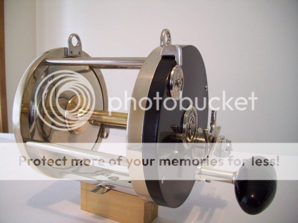

Glad you enjoyed the article. Here is a picture of the reel after Ray got done with it. The published picture did not do it justice.
Good luck on your quest for a Commander Ross. They do pop up from time to time, if you have to ask how much they sell for, then you cannot afford one. They are big bucks. That is why I do not own one. The one that Ray restored was a very beat reel when Ray received it. He put many hours into that restoration.
