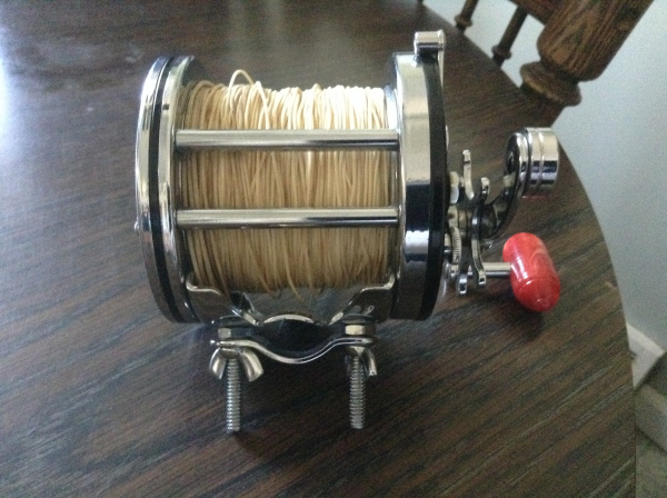

Just an early warhorse 114 with externally accessible drags and my favorite butterscotch grip. I had to replace clamp but had some left over from Cortez upgrades so net zero. The rod is crapppp but for $20 I'll always snag this one. Inside was nice, with steel main, and it deserved a good clean and lube.
A very solid winch John, and $20 is darn good bang for your buck. Money leftover to build a decent rod for it
Ted
Yeah...excellent way to spend a 20 spot...great buy John. 8)

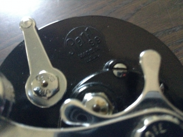

My Penn Silver Beach 99 which I purchased in the late 60's from Herman-Brooks in the Roosevelt Mall still has on its side plate "Penn 99 made in USA". Its has never been used.
#1153
 Beauty George.....50 years is a long time to hang onto any  reel.
 .....of course now it isn't nearly as common and in this pristine condition is nearly impossible to find.
 Ted
