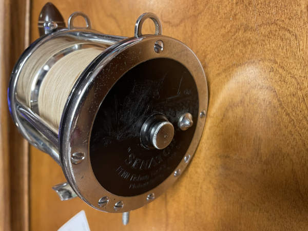

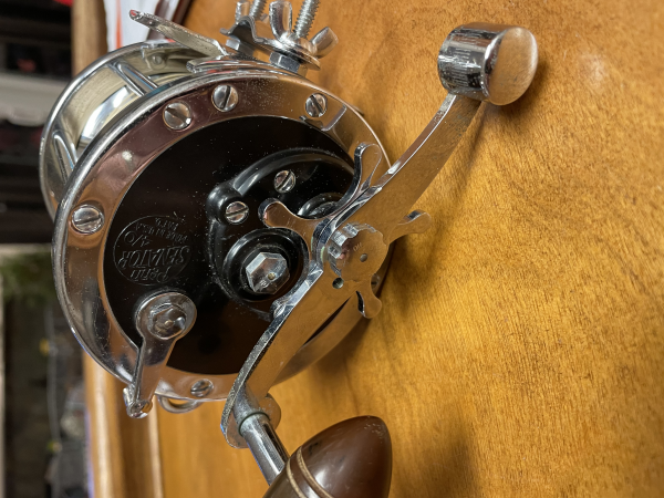

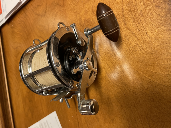

Can you guys help me date this early 4/0? I pulled the line off and it does have the skinny arbor with hole.
Im thinking somewhere in the neighborhood of 1940-41? Correct me if I'm wrong. Thanks
