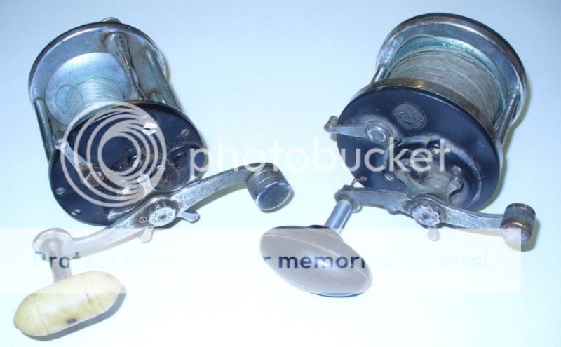

Ok New Era Math...1+1=700.....Finally won on an auction site that may rhyme with "GoodWillHunting" ::)...a Surfmaster 200 and JM 500..
Peeled off nearly 700 yds of mono from both reels...I swear I could hear the plastic spools groan as I peeled off full spools of mono..  :o
Opened both up to find a maroon spool that matched the side plates on the 500....and a badly chipped spool on the 200, but surprisingly neither spool was blown up under the mono....
But I did find something interesting on the 500...a square nut under the clamp post hex nut...but only one... ???
Well found steel main and pinion gears on both, and asbestos drags....gonna need a new spool for th 200, and debating whether to upgrade the 500 or leave as is....anyone have and idea on the 500 manufacture date?  Maroon side plates, maroon spool, steel gears, and amber (?) handle?....thanks in advance....Bill
That Jigmaster plate definitely looks old school. I Haven't seen one like it.
I would replace both those spools with aluminum or chrome brass at minimum.
Looks like a good score.

Really impossible to date the reel to an exact year without the box; but, yours is definitely an early Jigmaster.

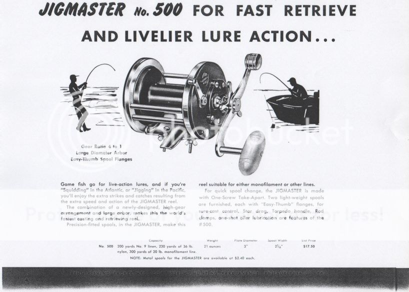

Here is the 1959 Catalog introduction of the Jigmaster:

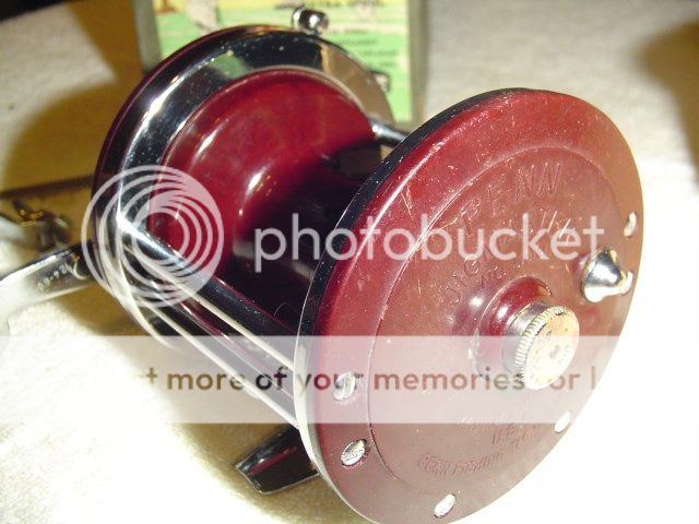

This is pretty much the reel you have pictured. Here is the reel from a 1959 box. Maroon with a white handle.
And the tail plate side, pretty much your reel:
If you put your reel in a 1959 box, you have a correct 1959 package. The Surfmaster is from the same vintage. But if you put those reels in a 1960 or 61 Blue box with metal corners, that could also be correct. But at least you have an early, first generation style reel. If you intend to use it, Then do as Daron says and upgrade the spool to a metal version. The plastic spools are OK, unless you plan on strong game fish. Those early lightweight spools were really meant for distance casting and will breakdown under heavy loads, especially with mono.
I have replacement spools for those. Either plastic or old three piece.
I replace them with stainless or aluminum.
If your going to fish it, They are a chance I don't want to take.
