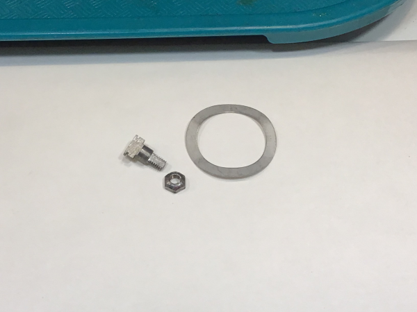

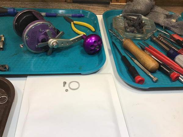

Are these the parts you need?
If so, PM me with your full name and address — and I can send them to you.
$5 + $5 shipping in a bubble envelope.

Hi, yes the threaded bolt is one piece I need, I think the nut is fine.
the spring I need is the wire spring that hooks into the slot on the bolt at one end,
and hooks over what I would call the "clicker lever" at the other end.
The spring is called the "drag spring" in the parts list, but it is an internal part of the anti-reverse mechanism.
What I referred to as the "clicker lever" is called the "drag lever" in the diagram.
It's amazing that you would have these parts!
The spring is shaped something like this:      _____O_____l
Thanks, Mike
OK, these should be the parts you need, I believe, Mike —
The part numbers you gave me I recognized from a later "Gladding" parts listing — after they assumed distribution and merged with DQ for the purpose of North American Distribution for a short period of time.
They got a few of the parts descriptions wrong, or mis-labeled.  The only spring on the "drag" that made sense to me — was the round compression wavy spring washer.  Sorry for the error.
Now I see what you are talking about — it is actually the anti-reverse dog spring.
If these will work, send me your full name and address — and I will get them mailed today.
They are new old stock from around 1960.

Thanks Fred, those are the parts exactly.
