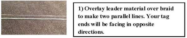

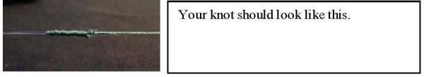

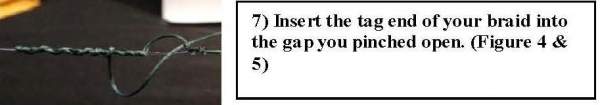

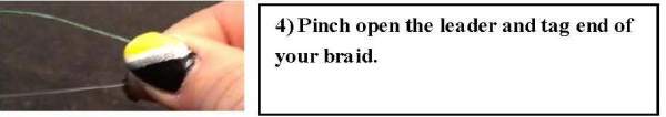

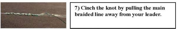

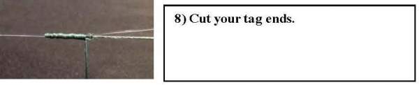

You can trim the tag end of the leader but if it is not cut completely flush it will make a clicking noise as it passes through the guides.  Cutting a uni knot tag end flush is not as dangerous as cutting a clinch knot tag end flush.  But, to be safe, I like to leave a 3/16" tag end on the leader material.  I then take the long untrimmed tag of the braid and tie a series of chain knots (aka lock stitch half-hitches) to lash the leader tag end against the braid side of the knot.  This makes the overall width of the knot slightly larger and it's not as slim, beautiful and quick as before. But, lashing down a protruding tag end is safer, makes the knot quieter passing through the guides, and provides better abrasion resistance.

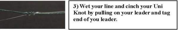

For what it's worth, I was using a FG knot (finger handcuff type knot) to tie braid to leader but had one start to unravel not long ago and am now afraid of the FG. I switched to a uni-to-uni connection with the tag end of the leader lashed down as noted above.
A nineteen-wrap clinch knot on the braid side of the Slim Beauty is probably as good or better than an eight to ten-wrap uni knot on the braid side.
Sorry to hear about your voice Alan, but glad it did not affect your typing too.  Wishing you a speedy recovery.
That looks like what is called a Bob Sands knot in Southern California.  A Tony Pena is the same except you just tie an overhand knot with the mono rather than a Uni.  When I google Slim Beauty the instructions I get show the spectra doubled and then not making as many wraps.
