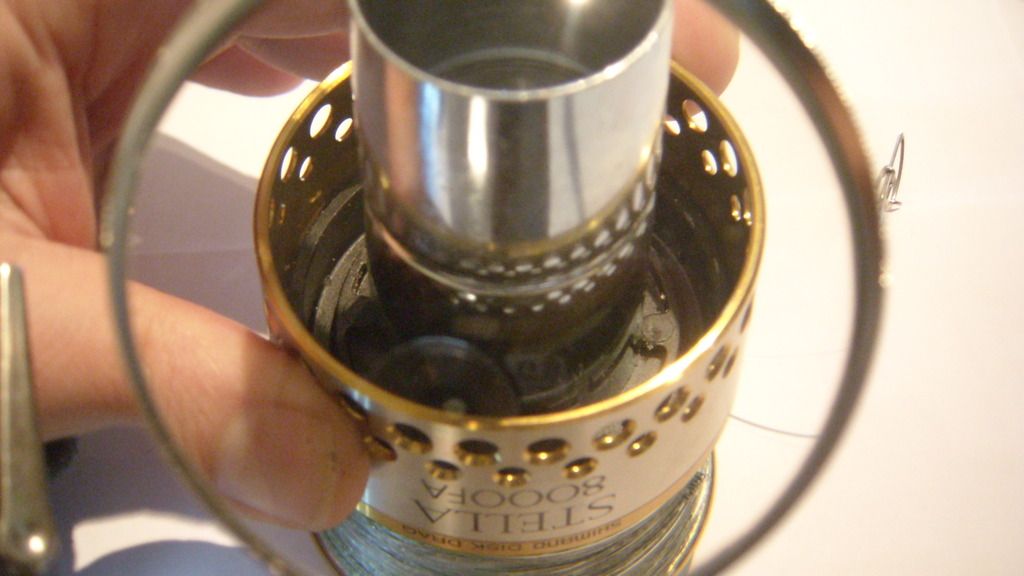

Does anyone know if there's a special tool that is meant to be used for removing the Drag Cover on the spool of various Shimano Stella models? I don't own a Stella myself, but I've been reluctant to removing this part since I haven't been able to remove it using my hands, and various tools that "kinda fit" is not something that I will apply to reels sent to me for service.
I tried Google to see if I could find more info, but I didn't find any tool for the job.
Any ideas? Thanks!
I have only worked on one, some time ago, can't remember the model. I made a 'Tool' out of aluminium but stiff plastic would probably do it.
Have a look at:

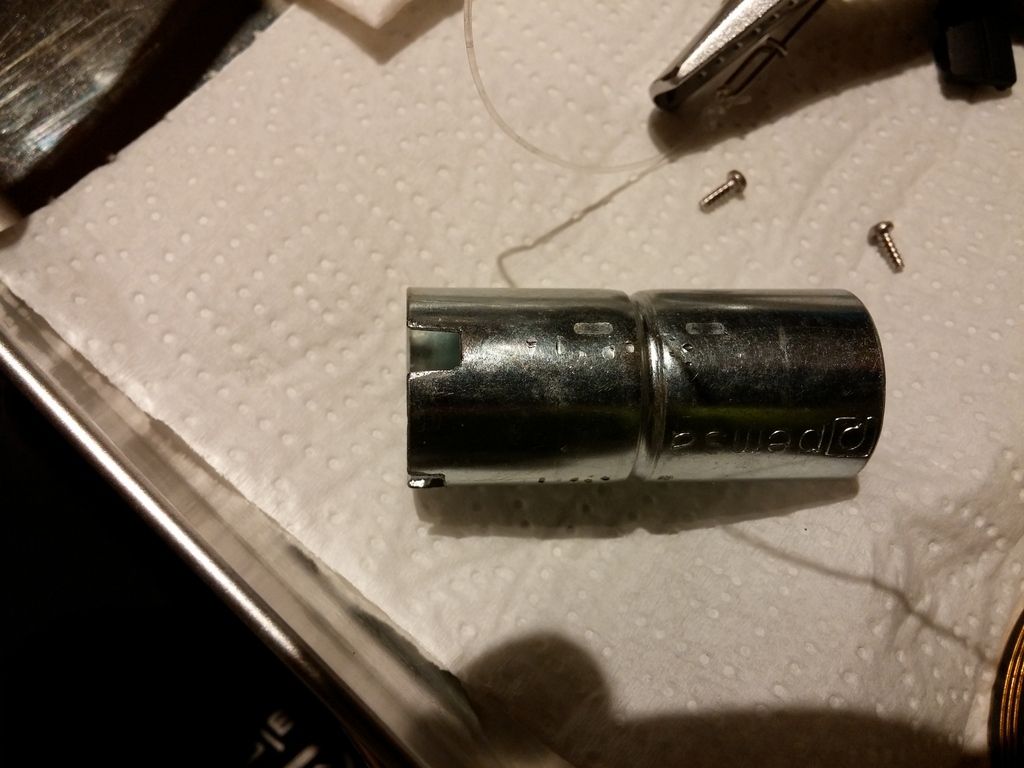

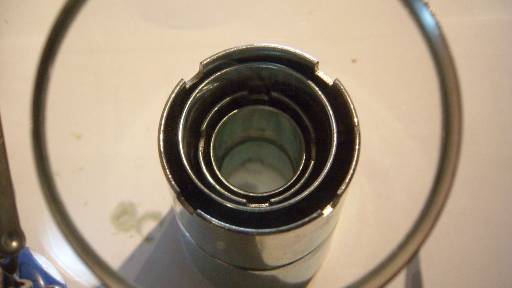

Hi all,
Again with this trouble. I have a few set made by myself but ... Is there a place who sold "standard" wrech for this work?  ???

What did you use to make the tool?
ReelClean
They look like conduit connectors...there should be a hole not shown for a set screw....Bill
Cadman
Quote from: TARFU on March 08, 2017, 01:18:21 AM
I thought the same thing a electrical conduit connector. What is the hole with the set screw for and where does it go? If you don't mind me asking a dumb question. Thank You.
No worries, when the conduit is inserted into the coupler, the set screw is tightened perpendicular to the conduit to secure it in the coupler...Bill
ReelClean
Ah yes, I can see that now, thanks!
Cadman
Quote from: TARFU on March 08, 2017, 08:47:38 PM
Thank You for the explanation.

Hi all,
Yes to all posts, all are correct. With the help of a dremel ...
Nobody knows if is there a standard tool for this works?
