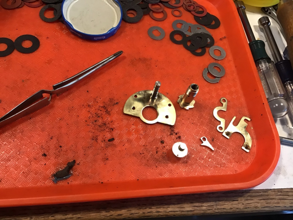

Now I will work on the right side plate. I start by removing the bridge screws.
As you can see, the sleeve needs to be replaced. The tip is rounded.
I have the true replacement, but I am going to go with a stainless steel upgrade (just my preference.)
The stainless steel sleeve had too much play, so I added a washer. It feels right now.
I will also be replacing the asbestos washers with HT100s.
The main gear is in pretty good shape, but at this point I am just going to replace it. We will get to this in a little while.
I will now remove the eccentric, bearing, and dog. I will clean the bearing as before.
The dog springs will need to be replaced. The one on the right shows wear.
I will now clean the yoke, the jack, and the eccentric and grease them. Then I will reassemble.

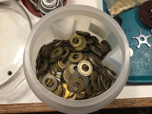

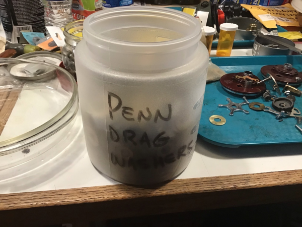

sal, where'd you get all the main gears?
