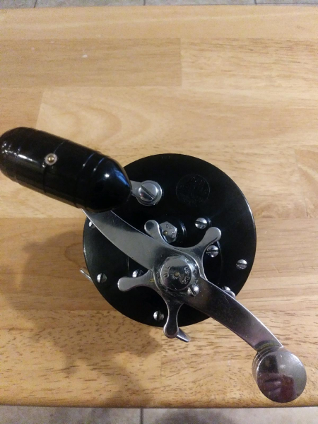

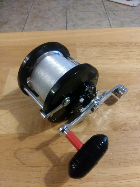

My inexpensive 285M isn't so inexpensive anymore.  It now has a mate and both have ss gear sleeves, 5+1 drag stack and 24-66 handles, 150 yds of 30 lb dacron and 210 yds of 30 lb Berkley Big Game mono.
We can't see it, Eddie...
Try holding it a little closer to your computer -- and crank it with the clicker on.
(In other words...We need pics, 😀😀😀)
285 is a great and under-appreciated reel that takes some of our upgrades very well.
Eddie K
#10
IM sent with pics.
I added (3) photos above of your 285, Eddie
Eddie K
milne
Eddie, That reel is looking great and by the looks your going to get some good use from her.
          I've not Delved into the 285 yet, but it is a bug, once you start Modding these old girls up.
        Great looking reel...
Col
Eddie K
Col, all my reels are old.  The last time I bought a new reel was 2003.  I have only recently started buying used reels, clean them up, lube and replace any worn parts.  The 285M's that I bought just needed cleaning and polishing as they were discovered to be unused when I opened them up to service them.
