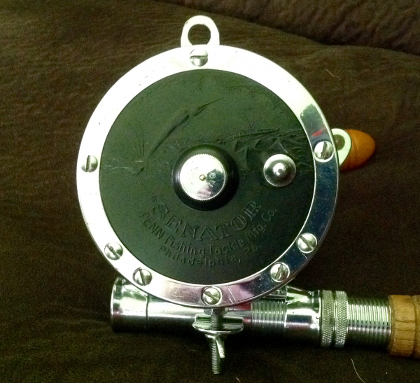

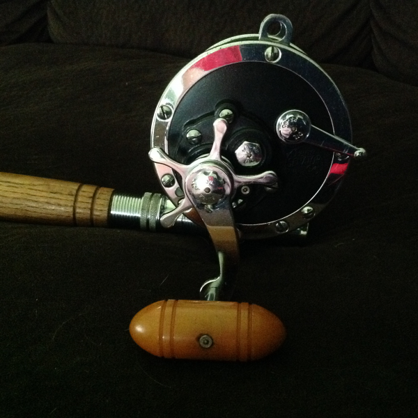

This is my first post here and I wanted to say hello and introduce myself. I have been "acquiring" fly reels for years and recently started doing the same with others. I was at a yard sale and I picked this senator up for $10 With a rod. The only issue that it has is the handle is bent. I would really appreciate any info on mfg date. I am guessing late 60s but have no idea.  Thanks
Welcome Tbrom, that sure is a nice 6/0 and only $10 ? WOW!           Rudy
TB that was a steal....good job on picking that up.....based on the part numbers present on the reel, we can only state it was built after 1950....that is basically when Penn started using part numbers on all the parts......if you had any paper work like a catalogue we could pin point the year.....if you could show us a picture of the bend in the handle we might be able to provide a solution......Bill
