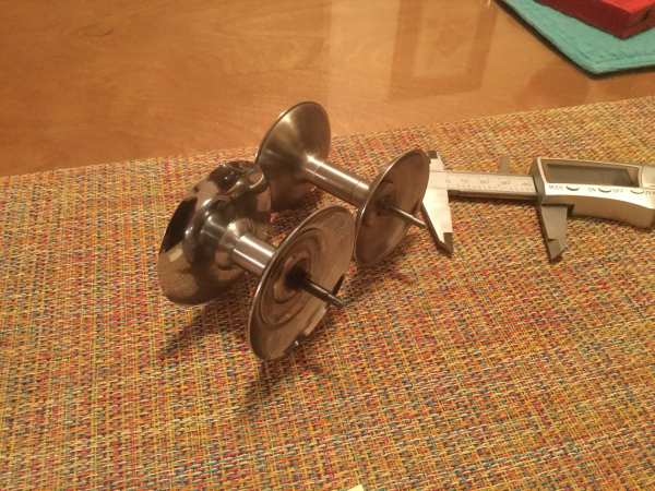

Now, about what has been driving me crazy for awhile. I want to put another Model 62 together. I thought I had all the parts when I started. Here is the spare spool I have that came with the parts.
The spool I have is the same width as the Model 62 spool which I removed from my known original reel. But, as you can see, the head plate side of the spool has a different shaft set up. This is what caused my problem.
Even though this spool is the same width as my Model 62 and the exact same diameter and it perfectly fits the Model 62 tail plate, it will not work because of the pinion gear engagement problem and the fact that the shaft is too short.
So now, I have assembled my original Model 62 and put it aside for future servicing and I am left with this useless spool.
I have one other question that I am still wondering about. Since this spool does not fit my Model 62, what reel does it fit?
Superhook
Mike,
The spool probably comes from a 150 yard reel that does not have a drag or a normal Free Spool Lever which moves the pinion gear on the spool shaft .
Possibly a Newport which relies on pulling out the handle for free spool. As it has a line post and not a drilled hole that dismisses most of the little pre '39 reels.
Ray
QuoteThe spool probably comes from a 150 yard reel that does not have a drag or a normal Free Spool Lever which moves the pinion gear on the spool shaft .
You could be right. I will check that later. Thanks for the next clue. Oh wait!! I do not have a 150 Newport or a 100 yard version. Artie did; but, he passed.....<:O(---Do you have a small 150 Newport? They are kind of rare.

The worm turns!       So far I believe the type shaft on my incorrect spool is the same type shaft used on a Penn Delmar, Penn 85 or a Penn Long Beach 60 or 65. The travel of the pinion gear on the mentioned reels is not on the spool shaft, it is on the long spool bearings. so, the incorrect spool I pictured is the perfect width and diameter for a Penn Model 62 and the perfect shaft style for a Model 285, 85, 60 & 65. So now I am stumped again. I know the spool I have is incorrect for my Model 62 and that also makes me doubt other aspects of what I am trying to figure out. My Model 62 investigation continues until the next post.

This might work, Michael --
1 21/32" width
2 3/8" diameter
11/64" pinion end
1/8" pinion end where bearing goes
This pinion end is slightly larger than the 209 shown -- 11/64" compared to 5/32" on the 209.
However, end and length are the same.
It was in the bin, and it is not numbered --
If you think it will work -- you are welcome to it -- I will send it your way (George may know) --
It appears possibly unused -- looks like it just fell out of the box years ago.
Please advise --

QuoteIf you think it will work -- you are welcome to it -- I will send it your way (George may know) --
I really wish I could say yes; but, it is one size off. It seems the size of the spool is correct as is the bearing size; but the pinion in the Model 62 is a Number 13-155 and takes a 5/32 inch shaft. The 11/64 spool shaft is the size for a Squidder or a Surfmaster.
Please save that spool for another needy guy, it is a great part. That spool you have is a very hard to find part. It would work perfectly in a 150 Coronado---Model 92 or the super rare Ocean Side---Model 82. Thank you very much for the offer.
QuoteIt fits a 78 Sea Scamp
Here the spool looks like it fits the Sea Scamp; but, again, it is strange because the Sea Scamp was made for over 20 years; but, never had anything but a plastic spool. So the spool I need seems to be unique to the Model 62 or any of the other small 150 yard reels made in the 1930 except for the Coronado or Ocean Side. Those have the spool that Fred has.

QuoteTwo different spool shafts for what is basically the same reel?
Yes, it surprised me also. I have many of these small frame reels. The 150 yard versions all are the same spool diameter and width; but they all do not have the same pinion shaft diameter. My small frame Coronado has a 11/64 shaft, as an Ocean Side model would more than likely share.
I pulled the spool from a 150 yard Bayside--Model 52 and it uses the same spool as the Long Beach 150 yard reel. All the small frame reels share the same spool bearing; but, not the pinion shaft. That does not make sense; but, I double checked it and that is how Penn built the ones I have opened so far.
