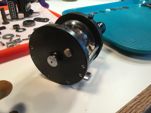

I bought a PENN 85 Seaboy off e-bay the other day along with a PENN 60 Long Beach.  Here is the Seaboy.
Sellers photo and as it looked when I received it.
It was spooled with leadcore line and I stripped it off after receiving the reel.  Here it is with the line removed.
I thought it might have extensive corrosion due to it's age and the fact that the leadcore line that came on the reel had been fished.  Well, I opened it up and this is just how it was - no corrosion at all.
I don't plan to fish it any time soon so I think I'll put some PENN grease on the clicker, clicker spring, and main gear and button it up.
ED
Ed, take it apart & service it. You said you like mechanical things. We are all here to help if you need it.      Rudy

I'm going to do that Rowdy.  I'll order the parts from Scott's and save the rebuild for this winter when there will be snow flying.
The folks at Scott's must think I'm nuts.  A couple weeks ago I ordered an Alan Tani wrench and then the other day I ordered a replacement reel (29L - 85 Black Aluminum) to replace a corroded chrome over Brass/bronze reel on a 60 Longbeach that I got the other day.  Then another order for the reel stand for the 60 Longbeach.  I forgot to order some PENN blue grease so I'll make another order for that and then order all the parts I'll need for the 85 Seaboy rebuild all in one order.  No big deal I guess but I gotta consolidate my orders in the future. ::)
