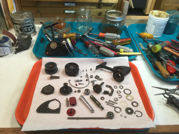

Trying to get caught up on reels this weekend after our trip --
Did a big 550 Quick for Alan yesterday.
Did a 221, 110, 330, 265, and a 220 for clients so far today.
All were complete restorations from the ground up -- including full disassembly, inspection, ultrasonic cleaning, any parts needed, new drags, buffed parts, Yamaha Marine, Syn Oil, tuned, adjusted, and polartec-bagged.
Like many of you, I have worked on thousands of reels -- but these old DAM Quicks, with their over the top component engineering, dead-simple bulletproof drive train, and clever operation -- never cease to amaze me -- from the tiniest Microlite to the largest Salt spinner.
This is why I choose to specialize in these reels -- along with Mitchells, Penns, ABUs, Cardinals, and other similar old soldiers.

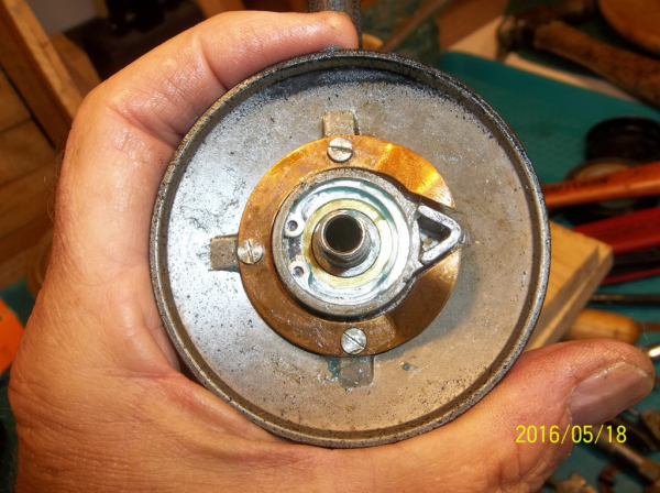

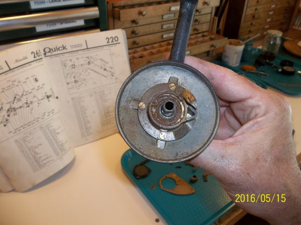

Fred, the 110n's spool button seems stuck to the top of the spool, and even more strange, I can lift the spool straight up pulling the main shaft out right along with it.
I haven't lifted it all the way out and the gears still seem to mesh properly when turning the handle, when I push it back in.
I purchased the little 110n from him kind of as a favor because he and my sis bought dinner for us last night.  ;D
I will get Fred to rebuild it as a favor to myself.  Darn cute little reel, solid in your hand.

Randy, the issue is that the brass spool spindle is rusted on the inside where it mates to the spool shaft.
Not an issue, but to resolve it so no parts are damaged beyond repair -- takes a certain high tech process that involves soaking overnight in penetrating oil, a pair of vise grips carefully applied in the right place -- but not too tight, then a couple of blows with a nylon or rubber faced hammer... against the small chrome spool release button.  That will back it off the cross "T" pin enough to get a wrench to turn and twist it off.
Then if not rusted too badly -- clean the spool shaft and inside of the spindle with steel wool and finally Nevr-Dull until shiny and smooth.  Then clean the two parts again with an US cleaner, or similar -- to remove any bits of wool.
This happens when folks do not grease or oil the shaft where the spool snaps on.  I just use syn oil on these to allow the keeper spring and ears to work freely and to protect against results of water entry.
To get at everything easily -- just unscrew the red drag nut, remove the drag system -- and the spool slides off from the stuck brass spindle.  Then inside the body, just pop out the screw or keeper pin on the oscillating arm block -- then it slides out to where you can work on it.
These shafts will bend easily on the tiny 110, 265, or. 110N -- if too much pressure is applied -- that will spoil your day.
Any tweak will keep it from running true through the pinion.
Glad to help -- just send them over or try it yourself.
