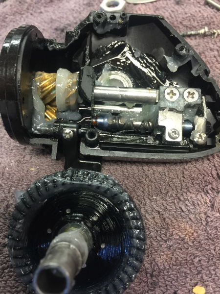

Zimbass
Have an Shimano Aero Black just a little smaller, in the 6-10 line size class, that a friend asked me to look at for him.
It only turns in one direction, backwards ! The reel is stripped on the spool side, so the anti-reverse is not in play.
I am not a spinning reel fan, so do very few services on them. Is there a special way the pinion gear and anti reverse cam are fitted ?
If anyone can point me in the right direction, or advise of any tutorials I can look at.
Very annoying ! Give me a baitcaster any time  ;)
Thanks.
Terry.
(PS It is a rear drag, and has the fighting drag too).
