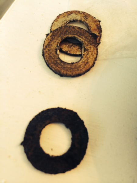

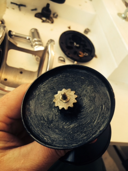

A light coat of grease on the left side of the spool, then i started to clean the bridge, replace the gear sleeve with the new stainless on from Mo, and install the new 5 washer stack from Dawn.
The bridge, gear, and sleeve were just nasty. It was covered in a reddish rusty grease. Someone had actually already done a 5 stack conversion, but the corrosion was bad enough that the first 3 washers were so stuck in the gear I had to use a punch to get them out, even after an hour soak in Simple Green.
Is there still a washer in the gear? Or is it that Nasty?
Looks like some salt water got in there and went to town.
Clean up that gear with a wire wheel on a Dremel Tool.
If you don't have a Dremel, Some fine sandpaper or emery cloth.
Based on the rust on your fingers, You need to clean that up and put the new stack in with some Cal's drag grease.
Keep us posted.
spc7669
I also noticed a tick in the sleeve before I took it off to replace it. The post on the bridge has two nicks I the slot where the pin goes. I hit them with a file and it's better, but not perfect.
The main gear is still soaking in Simple Green. I have noted some pitting inside the gear.
Should I just go ahead and order a new bridge and gear?  I haven't been able to source stainless ones yet, but it appears Scott's has both in stock. I'm already way into this build. Another 25 bucks is not the end of the world.
