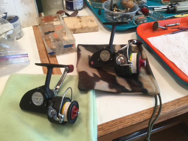

Finished up a little Microlite DAM Quick 110 for a client today -- to match his 221 that was completed yesterday.
New gears, drags, a few new parts -- complete and ready to roll.
These 110's are good, solid little reels for trout, bass, panfish, etc...but will also handle a large fish if caught incidentally -- due to the tough drive train.
The 110 is 5:1 & the 221 is also high speed at 5:1.

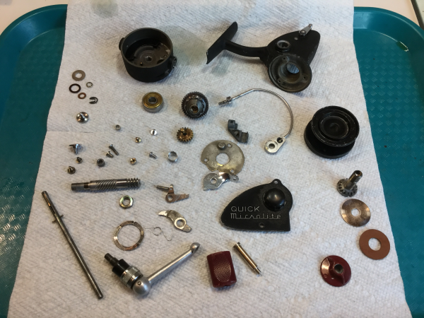

I have never seen a Microlite in better condition after 56 years, and just ultrasonic baths in degreaser and simple green.  These are remarkable reels built by a generation of German Craftsmen and women who took pride in their profession -- just like Keith mentioned.
If you find a good one on ebay, Andy -- it will likely need a disassembly, cleaning, reassembly, synthetic grease & oil -- then be ready to go.  If you need any parts, help, or advice -- just let me know.  It is easy enough to walk you through any tricks and sinkholes.

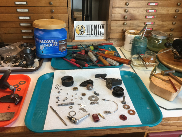

I appreciate the offer for tips and help I've read over all your how to and pictures of these reels. You've already been a big help I got a finesse I believe 330 series got if for cheap needs a good cleaning and lube as you mentioned everything seems fine except it's missing the nut that holds the bail wire on the end of the rotor with the line roller. Also Fred what  do you know about the dam 101 reels?
handyandy
I'd be interested in a complete reel too if you have one to spare I'm fine with one I have to go through I've already fixed up a old penn 722 and 430 need to pull apart this finesse I have and go through it will probabaly use it for a catfish rig wanting a small dam for a bass rig waiting for a 220n to arrive I bought for cheap probably will go on a stiffer bass rod for flipping jigs in cover
#11
If you will PM me your address, Andy, I will sent out a hex acorn nut and a lock washer for the end of the bail by the roller -- N/C -- for the Finessa, which was the precurser to the 330.

Glad to sell you a complete reel, if that is what you prefer -- but I will not sell a reel unless I have gone through it 100% --  and replaced anything needed with new.
Many folks do not understand how these reels work -- how the old brown factory grease gets turned to beeswax, how to tear them down completely prior to modern grease and oil application and tuning, how to evacuate and analyze the bearings and other parts.  So things get done 90% -- and the 10% becomes a problem, at least to me.  I just like it right when you receive it.  No offense...
