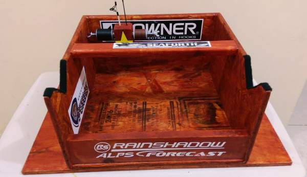

so, recently while working on something around the house, I got a MacGyver moment and visualized my carry-on wood tool box I made few years back as a prospect for my hand rod wrapper station.
well after a short visit to my local hardware store, and after few hours working on it late night I came out with this..
my carry-on hand rod wrapper jig
this next pictures were taken actually testing the rod wrapper on a rod, I didt finished to rod this time to show you how it was, but so far soo good, it felt really good while winding some thread on the rod (which its one of the pending to fix rods)
as you can see, Im using two broken rod tips section as line guides, I have the option of use one or two line guides if I need a different  thread color
line guides (rod tips) are not permanent there, I made two holes on the slinding piece of wood of 4" deep on which you stick the rod tips, this way they cant get out on their own while using them, but for storing purposes you just take them out from the holes and put them on the floor of the box
it also has a long screw (worm screw??) from side to side of the box on which I put a piece of wood that can slide to move the winding thread rolls and line guides to your preferable zone.
winding thread tensioners dont need much explanation, right?
and finally a velcro strip on one side of the box to hold the rod and keep it steady.
it came out really a lot better than I though it would, for know I will use it to finish the pending to fix rods and decide to keep it for next jobs or made the one I was planning since the beginning.
now I will just put tons of small fishing decals on it, a dark color felp floor (I already have some) and call it a day... ooh and start using it

Great job! That will do any repair you need to do.I built on too, out of scraps and some stuff from the hardware store.

Very cool. Definitely better than what I'm using. I'll have to put one on the list. Thanks for posting.

thanks guys for your kind comments, best thing about it (IMO) its that once you finished your work with it, you can put all the accesories inside the box along with small Plano boxes with thread, guides, tiptops, etc, then put the wood box on a corner and put another storage box on the top, its really a space saving thingy for small places like mine where I dont have a Man cave.

Really wonderful idea and execution .
I think half my life has been McGyver moments.
I like it alot.

seems that I will keep this to-go hand rod wrapper for long, this weekend I did my 1st ever guide winding with it and worked like a charm, I used a really cheap rod I got on a local flea market, it was already fishable as it but two guides were really beat up so I changed them.
well this is how one of the new guides was wrapped.
NO gold or silver trims on them cuz the rest of the stock guides were this simple, just black winding thread and thats it.
still need the coating them
Well done, Alex! Your design is a lot like the one I use http://www.mudhole.com/CRB-Hand-Wrapper-System-HWS-1

Sid, that design centanly looks similar too mine, cool coincidence, that CRB wraper, is a factory made hand rod wrapper that seems like it was based on DIY rod wrapper designs from people that dont want, need or affort a power wrapper/drier jig.
its cool for guys that dont like DIY thingies, I am one of those guys that normally enjoy more making or building diff things that actually using them LOL, I really hope this will never apply to fishing rods.

Alex, genius use of broken tips. I'm hand tensioning thread out of a little pan....

Quote from: steelfish on August 17, 2016, 07:30:10 PM
fishing stickers... Done
dark color felp floor... not needed but tinted on dark maple
start using it...... Done
check the final version of the carry-on Hand rod wrapper
yep, our Scott's bait and tackle guys
and this is how I repaired and installed two new rings to an old spinning rod with sentimental value for a friend, I didnt wanted to mess a lot with the stock trim bands so, I continue the wrapping with the best similar color I found... I think it ended up good.
