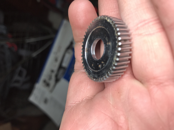

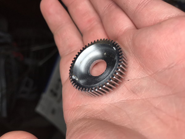

Anyone recognize this jigmaster gear? I got it on a jigmaster 500 from eBay and have 5 others(mostly jig 500 or 501) but this is the first I've seen that has an indention on the underwasher side. It also seems like it could be stainless as it's much shinier than other steel gears I have.
Other question. This is the only reel I have that I can just slightly shift the spool towards the right plate which causes it to bind. It did this with the plastic soool it came with as well as another aluminum that does not do this in the other 500/501's. I did not compare the pinions to see if the one it came with matched my others yet. Is this an upgraded/aftermarket gear or did some jig masters come with the indention from factory.
Other than it not coming with only 1 upper bridge screw(I just put one from my other reels to test it) it's in very nice condition after a deep clean(which had what appeared to be caulking or something as lube, it was horrible to scrape off!)

newell made a gear with an undercut like that, but that does not look like a newell gear.   :-\
#324
That is an earlier Penn gear. Run into a few, especially Surfmasters and Squidders.
By the way, those are chromed steel gears and not stainless steel.
They're very durable unless the chrome peels off.
Actually they would still be durable if that happens, but you would need to deal with rust.
I do see the chrome starting to wear, a good coating of grease would keep them nice.
I have one or two of those. I always thought the undercut allowed Penn to use one size undergear washer for the smaller reels and Jigmasters.
