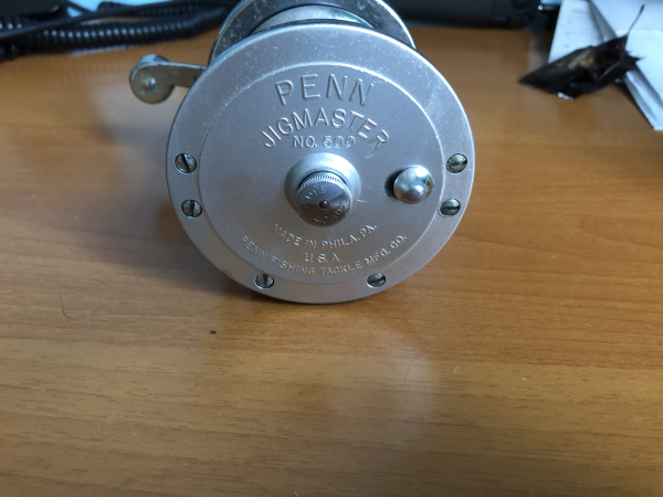

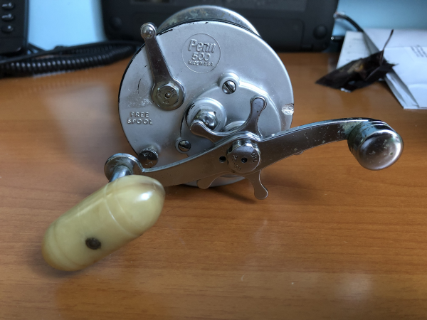

I was trying to paint Jigmaster side plates. They faded in 30 years.
Any recommendations.
Thanks
bhale1
 ;D....I would say if thats what it looks like after 30 years, then keep on fishing it!!!!!
Brett
#313
Honestly, repainting or stripping, it's not going to look that much better for very long because of the tight clearances and the wear on the paint. If the appearance bothers you, repaint.
