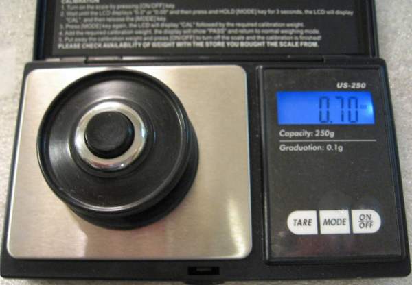

This is an original early Cardinal 3 plastic spool. It weighs in @ .70 oz.

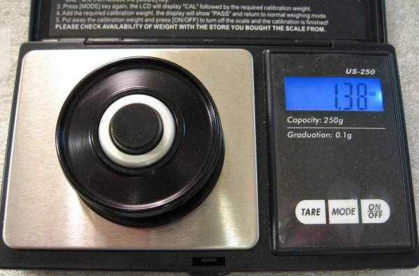

This is an aluminum Cardinal 3 spool. It weighs 1.38 oz.

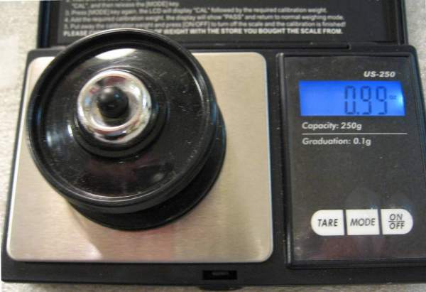

This one is the earliest version Cardinal 4 plastic spools that was used from '69 - '74 and basically weighs 1 oz.

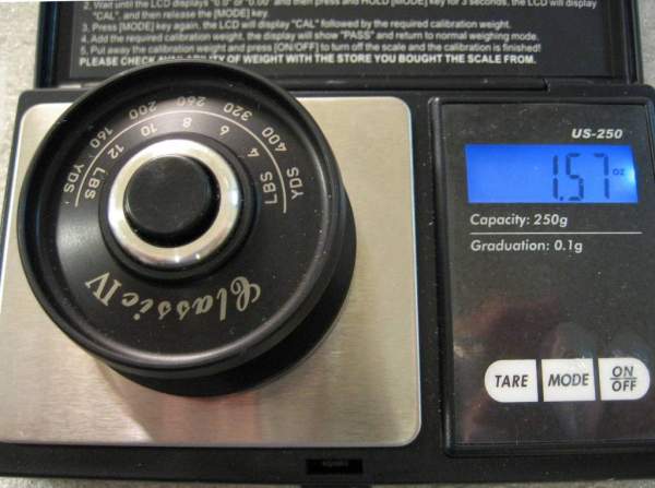

This is a SporTech/American Classic IV aluminum spool (fits all green & tan ABU & Zebco Cardinal 4s) from 1997. It weighs 1.57 oz.

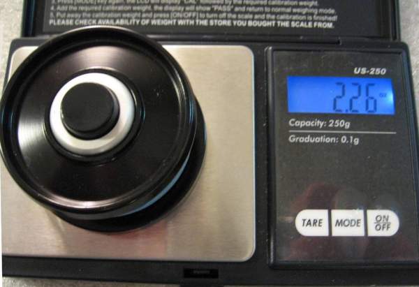

This is a Cardinal 4 aluminum spool filled with 20 yds of 12# Dacron backing & 130 yds of 8# Trilene XL mono. Total weight 2.26 oz.

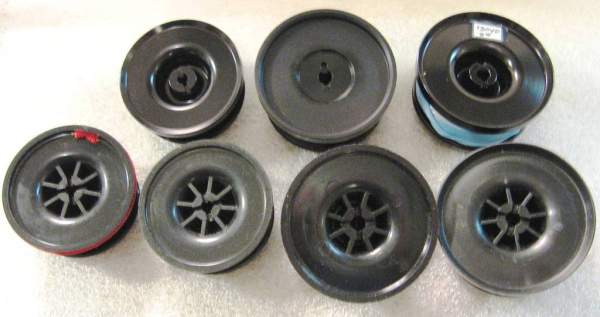

Here's the back of all seven spools. The top row are aluminum and the bottom row are plastic. The 3 on the left are Cardinal 3s and the 4 on the right are Cardinal 4's. Notice the difference in the surface areas around the main shaft hole.

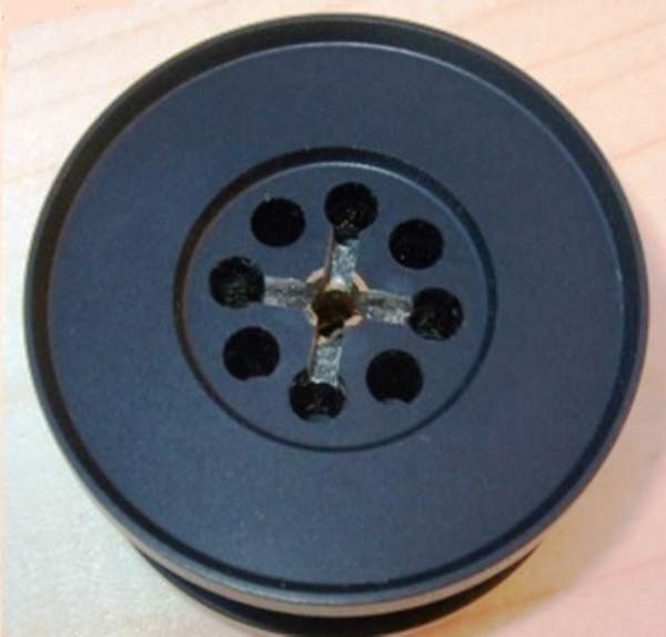

Here's the back of another style aluminum Cardinal spool. Both the 3 & 4 look the same here. It has 8 holes drilled to reduce weight. The grooves for the main shaft cross pin have been ground in and those groves are sometimes anodized.

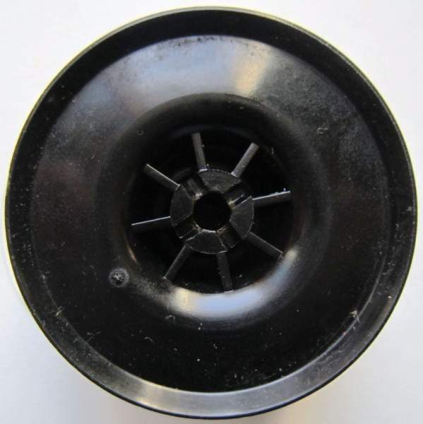

This is a plastic spool that has often been advertised as aluminum. It is very hard plastic and difficult to differentiate without cutting into one of those spokes. Notice the mold mark and the molded #2 directly across. Don't be fooled by this one.

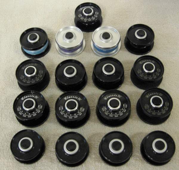

These are my extra Cardinal 3, 4 & American Classic IV aluminum spools.
