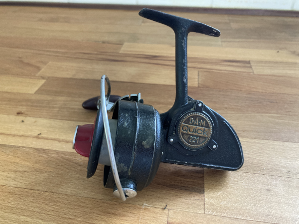

Ruffy
Picked up a 221 recently for cheap on gumtree. It's completely functional as is (just missing the plastic tubing on the bail arm), but I've got a semi completed 221 pretty much ready to go that will get a few parts from this and be ready in about 30 minutes!

Ruffy
All buttoned up and ready to fish! This was a 95% 221 I had cleaned and burnished ready to go, minus a few parts from a previously rusty life (see the 221 breakdown tute page 6).
