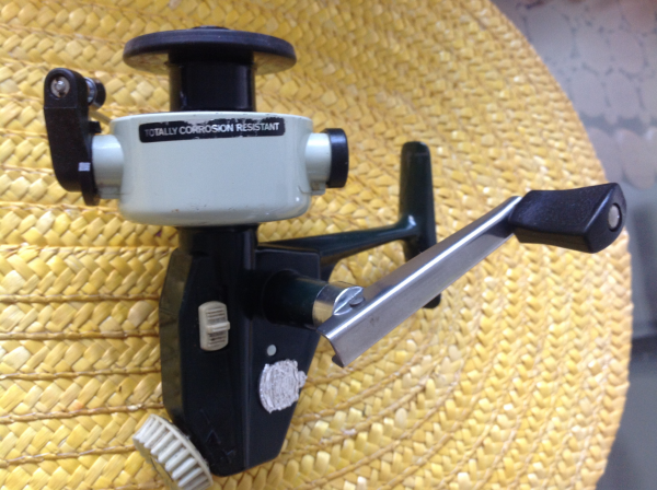

Here's my "TOTALY CORROSION RESISTANT"- 4. It came from the upper midwest. So I guess it was a sales point to claim this. Maybe they all came outta the factory that way?

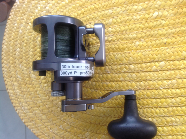

I've got an Avet SX 6/4 MC w/P-pro on it, that sits in my car as a back-up. I dislike the way the pinion bearing can so easily get crunched by high sunset drag numbers(stated max. drag: 14lbs.). I recently replaced that and another bearing in it.
Think about it. The 6 and 7's seem to be 50 -100$+(good condition) on da bay and not real common. PM if interested.
