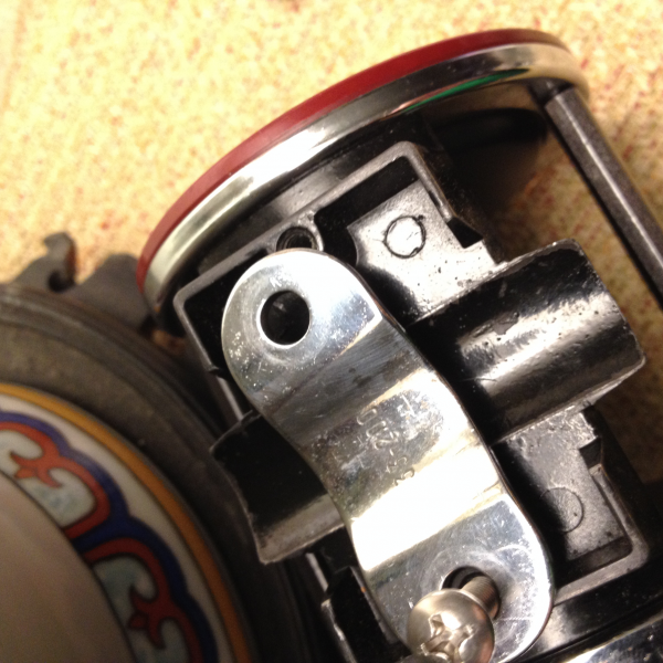

Quote from: Alto Mare on May 04, 2017, 09:07:48 PM
The 33-200 will fit the narrow Jigmaster stand. The screws will also work, but I'm not sure on length, you would need to determine that once the reel has been mounted on the rod.
Sal, I am looking for a clamp for a Newell stand on a Jigmaster.   I believe the 33-200 is the same width as the 33-113 (https://www.mysticparts.com/PennParts/Parts/33-200.aspx).  I need a little wider clamp for the Newell stand.   I'm all set with the screws. Thanks.  /Joe
Joe, the 33-200 clamp will fit the narrow and standard Jigmaster. You might need to get the correct length on screws.

Quote from: Alto Mare on May 04, 2017, 11:06:28 PM
Sal, your picture made me check. The 33-200 has a width of 1 7/16 between centers of holes. My Newell bases have a width of 1 11/16 between hole centers. There is a 1/4 inch difference. With long bolts it could work but I'd like to find a better match. I haven't ever owned any Penn bigger than a 113, but maybe a clamp for a larger reel would do it.
Or maybe I need to beat a 33-200 with a hammer until it opens up a 1/4 inch  ::)

Joe, I don't think you have a standard Jigmaster, yours is probably a wide.
I double checked my dimensions and there is only 1/16" difference between the two that I have (standard and narrow).
The holes on the newell clamp are 1/8" in diameter, on the penn 33-200 they're 1/4".
This is why the 33-200 works nicely on both reels.
Let me check what I have, if I see anything 1/4" wider I'll send it your way, but don't hold your breath.
Maybe Fred will be able to finds one for you.
Just to make sure...
Is the ID on that reel 2  7/16",  plate to plate?

Quote from: Alto Mare on May 06, 2017, 10:51:36 AM
Sal, mine is 2 7/16 plate to plate.    ??? ??? ???
