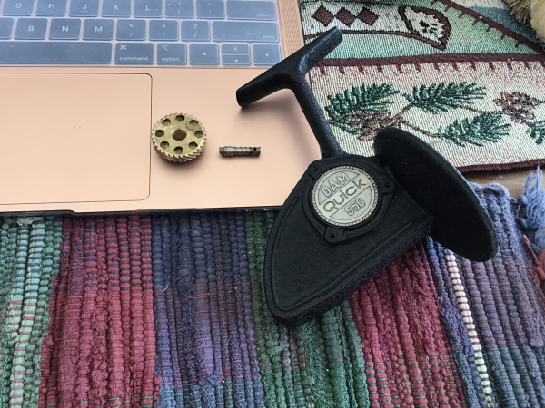

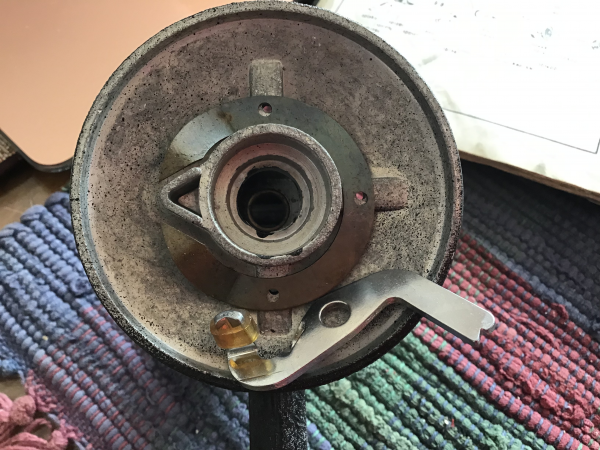

Fred, l just now noticed for the first time there is a second rubber buffer on the schematic you posted. Where does it go? l know part no. 100248 fits on the angle lever.
 :)  These pictures may help
festus
Thank Joe. the second pic answered my question.

#27
Yes, Festus, it just goes on the underside of the trip lever —
It interacts with the triangle trip nub moulded into the reel frame — and also with the copper ramp — to trip the bail.
A DQ reel's bail should properly be put into the "casting" position starting at 12 o'clock and going downwards to 6 o'clock.
This gives the rotor rotation about 270 degrees of momentum before tripping closed.
Another small detail when casting these —  for a more accurate and longer cast — it helps to make sure the spool is in the full outward position.  Less line resistance as sometimes an inward position will cause a slight friction on the inside of the rotor — as the line flies off the spool when casting.

l have tubing l can cut to take care of this, but do any more of the non-N Finessa series need this buffer?
