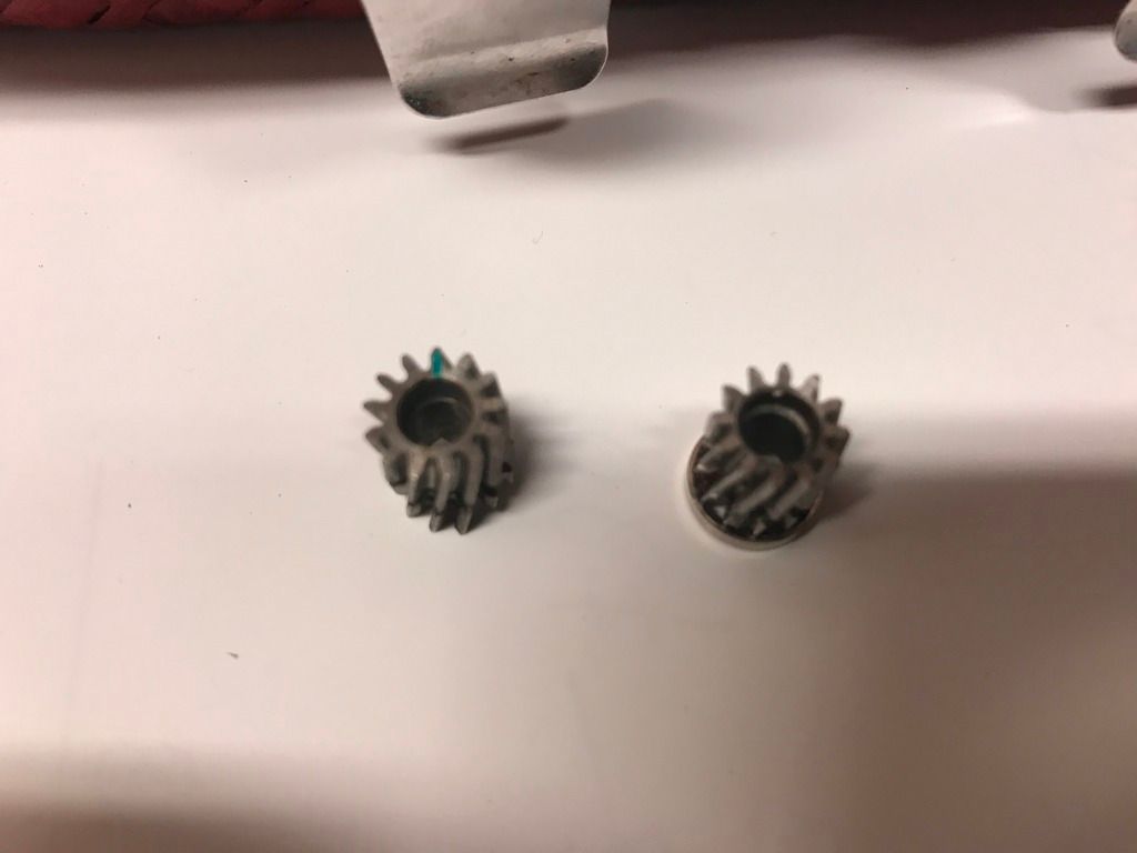

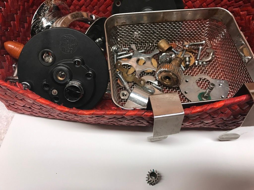

Jenx, I happen to have one of the really early 99's on my bench at the moment, this one has 13 teeth
Jigmaster's pinion on the right
Not sure about the later models, but most 13-99 that I've seen don't come with the ring as the jigmaster does
3.7:1 vs 4:1 ratio isn't really that noticeable on these reels, I would suggest keeping a fully assembled Jigmaster head plate in case you wanted to make the switch.
You would then go from 3:1 ratio to 4:1.
Just a thought.
Just checked my parts envelopes -- same as Sal -- 13 teeth.
