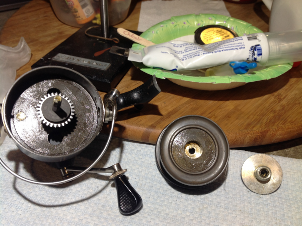

Hello all,
I was wondering on how to clean these reels and re-grease them. They were my reels from when I was a kid, haven't used them in 20 or so years. My father passed away last year and I recently just picked fishing back up. I switched them from left hand retrieve to right hand retrieve, spinning with the left hand is right hand retrieve? My dad was left handed and was teaching me left handed, I'm right handed. I have little knowledge on the last time they were even maintained. My guess would be some time in the early to mid 90's. Also, can anyone tell me why when I put the 220 in "forward" retrieve righty, if that's the correct term, it clunks in the same spot every time time I reel? It doesn't do it when you put it in reverse but it did make this clunk before I switched it over. I'd like to get both of these reels back up and running, nothing sounds better than a DAM quick reel in my opinion. Plus I'd think it would be cool to use my reels from when I was a kid.

Hi Capt --
There are many ways to remedy a problem on any reel -- if it were on my bench -- this is what I would do -- everyone may have a different approach...
Initially, try to determine where the catch is --
Remove the spool -- see if there is still a catch -- could be as simple as a trip lever spring touching the underside of the spool, a missing spool spacer, or the underside of the spool touching on the spring loaded click cog.
If not these -- move inside the body.  Before that, put the A/R lever in the middle neutral position -- see if there is still a catch.
If still a catch, then it could be the copper trip ring ramp under the rotor that is attached with (3) screws -- bent out of even positioning.  Could also be the trip lever bent slightly too far down towards the copper ramp up ring.
If still a catch -- could be a burr on the main gear -- although this is unlikely -- they are so HD tough.
Also check the A/R cog that interacts with the 8 holes in the main gear -- it could be rough.
In this order -- one of these will most likely be your culprit.

Thank you for your reply Fred. So I put the A/R lever in the neutral position on the 110 and the 220, no more catch on either reels. Catch is only there (for both reels) when its in the forward position with the reel lever on the left side. Sorry that I know little to nothing about what you're talking about, but I want to learn. Should I break these reels down and attempt to clean them? I'm willing to learn, like I said, but I don't know if these are the reels that I should practice on since they mean a lot to me. You say you service reels for members, would you be willing to do mine? No clue how much you charge but I really want to start using these reels again.

Sounds like an internal A/R issue -- possibly a gouge or burr in the backside of the gear, bad spring, or? -- we will need to check it out, Capt. --
