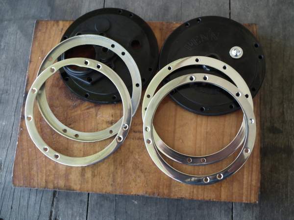

Chris (Rothmar2) has been quietly making more master pieces - I received a set of 316 stainless 349 rings in the mail last week. As we have come to expect, they are spot on, great machining with a brilliant polished finish. Thanks a million Chris.

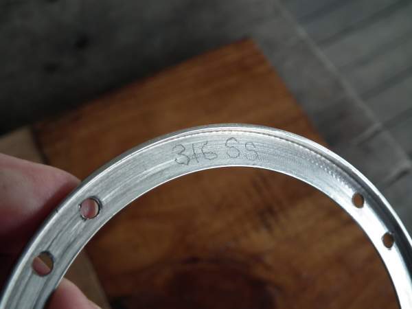

Chris IDs the material on the inside of the rings;

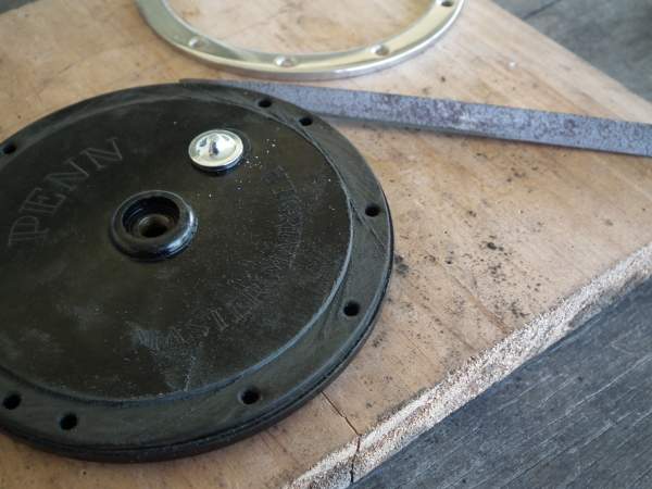

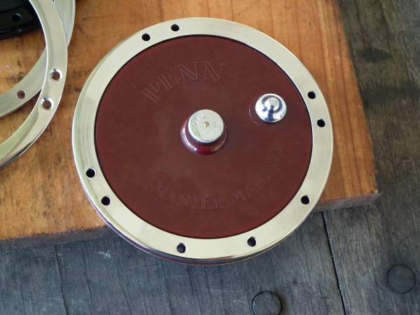

The subtle differences in Penn side plate sizes was highlighted when I test fitted these on a few sets of plates. They are an easy fit on a red set I have;
They are also a good fit on the black plates Chris used as a template but are a little too tight on a couple of black sets I tried - not by much but they wouldn't fit in the recess around the outside edge of the tail plate;
I wanted to use the black set with a single eccentric lever, so I filed a little material around the edge of the recess with a triangular file;
