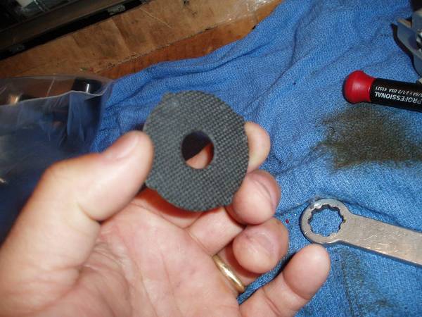

now, on to the drag washer.  this one's clean as a whistle, front ....
.... and back.
i've applied a thick coat of shimano drag grease to the inside of the spool and to both sides of the drag washer.  the purpose is to protect these surfaces from salt water intrusion.  apply enough grease to prevent water from getting in between the drag washer and the spool.
now wipe all the excess grease.  and i mean all of it!  when you're done, you should be able to look at a greased washer and a dry washer and not be able to tell the difference.

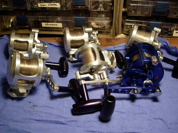

so a guys sends me six avets just before christmas.   ok, fine, i don't get many of these (this is a good thing).  i've never written an avet rebuild post so i grab my camera and i take a shot of the reels....

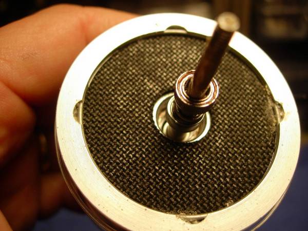

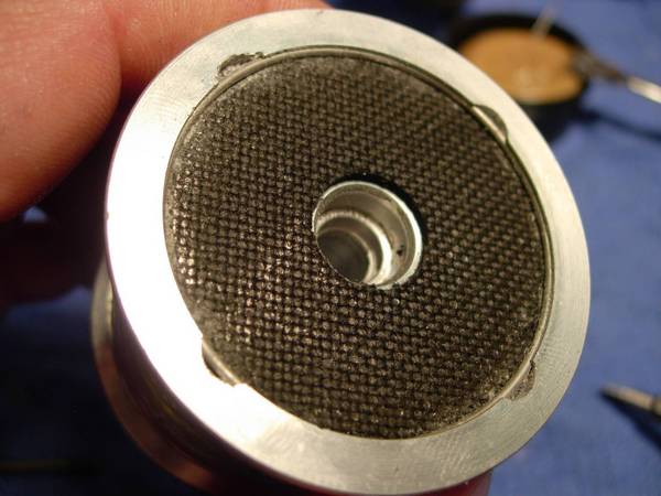

i open up the first reel and i'm horrified!  here was the working side of the drag washer....

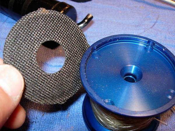

but this is what i found underneath.  we'll call this reel #1
i called avet and they said to just clean it and reinstall it.  so i cleaned it....

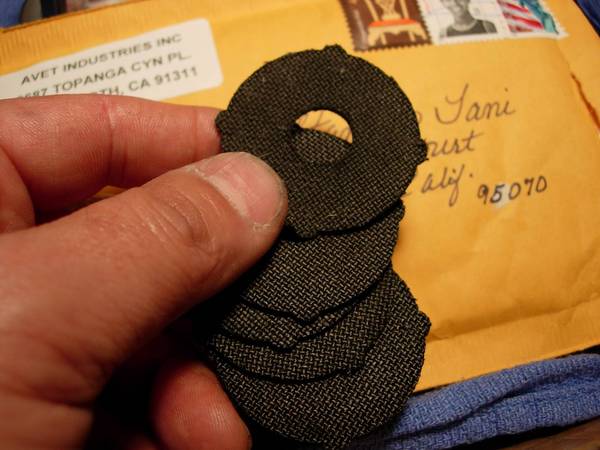

but decided to order new washers....
and some grease from cal sheets.

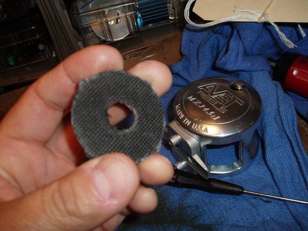

here's reel #2 with drag washer that's clean as a whistle.

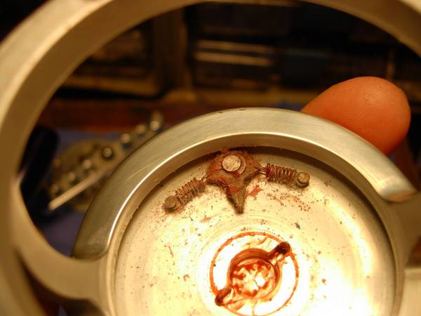

here's reel #4 with extensive salt water intrusion .

the reels were all rebuilt with no change in bellville configuration.  the first three mxj's had drag washers that were greased with shimano drag grease and all three delivered 9 pound of drag at strike before losing freespool.  the last two mxj's and the jx were rebuilt with cal's drag grease.  the two mxj's delivered 9 pound of drag at strike before losing freespool.  the jx delivered 12 pound of drag at strike.
so here's what i like.  i like the open design of the avet drag chamber.  without a spool cap to cover the drag chamber, yes water will get in, but it will also get out.  sure, a cap on the drag chamber will keep small amounts of water out.  but if water gets in, it's trapped.  that's the main and fatal problem with the penn 975 lever drag.
i don't like the fact that avet uses a dry drag washer.   i saw no loss of drag range in these six reels with grease on the drag washers.  and i'm certain no one would disagree that grease would stop the corrosion dead in it's tracks.  it's my opinion that a grease drag is a good thing.  either shimano or cal's drag grease should work just fine.

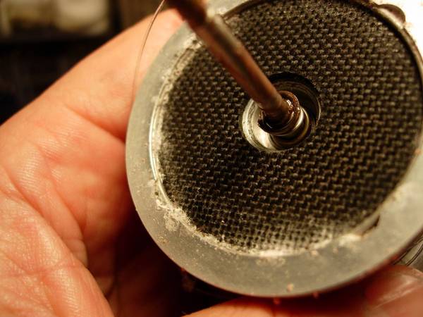

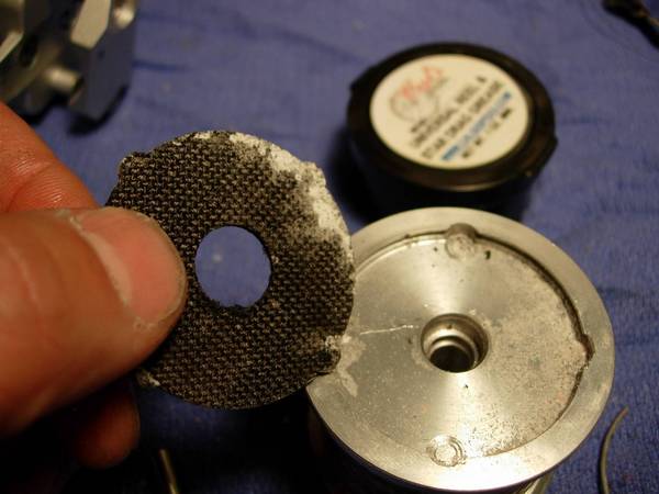

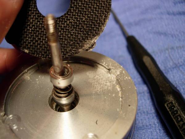

I just opened up my two SX reels - about a year old - to grease / clean for the rockfish season.  They were in very clean shape inside, but the drag washers were completely stuck to the spools.  I mean... Like... Glued.  On the first one I thought it might be corrosion or dry grease or something and pried a bit.  The washer delaminated leaving the bottom layer of carbon stuck to the spool and the rest of it came off.  The 2nd one was similarly stuck, so I didn't pry.
Help?
if there was no retaining ring, there you likely have a later model with a drag washer that is glued to the spool.  if the drag washer has come off, then you will need to clean the metal surface and use epoxy to glue on a new washer.  otherwise, just apply drag grease to the drag washer and pay particular to the edges.  you don't want salt water creeping in under the edges.
benha
Oye.  Crud.  So now I've really messed it up.  Okay.  I'll see if I can scrape off the remaining bits of the carbon washer from the spool and get another one glued on there.
Didn't realize they glued the washers on!
