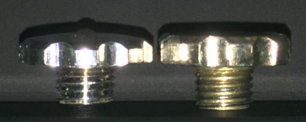

He handle nut on the left is from a Penn jigmaster and the right from a ProGear 255.  They are the same length. The ProGear are are thick aluminum. In fact, of similar thickness to Maxed Out handle arms at the recessed handle but area.  But the overall handle arm is thicker and feels more ridged than the OG ProGear handle arms.
As I stated before, my concern was with the amount of threads on the handle nut but I know many have used the ProGear handles on not only ProGears, but PENN reels, without any issues, and therefore, my concerns have been addressed and have been proven to be more than sufficient securement of the arm to the gear sleeve.
