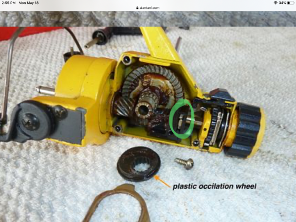

Tommy, Sorry I have been so long getting back to this.
It looks like the plastic clicker is also the only drag washer?  I have not been able to remove the spool shaft, which means I can't remove the main gear.
Any suggestions very welcome.
Greg
Hi Greg --
Not trying to butt in -- and Tom will know for sure...however, there is a little metal "horseshoe shaped" retainer that can be removed with a small screwdriver, needlenose, or tweezers.
It is shown in your photo tucked into the carriage slide.
The spool shaft should come right out when this is removed.
