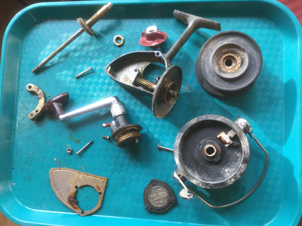

The DAM Quick 440 is not a very well known reel, even among folks who know the Quick models and various lines.
It is considered a light heavy-weight spinner for extra heavy fresh water fishing.  Also for light and medium salt water use.
Second largest of the Quick Line — between a 330 & 550.
While it has the body size of a 330, the spool and rotor are much larger.  Plus the bail trip is a unique and very positive system for fishing current or large fish where we don't need a sloppy bail.
Client sent this one in that he purchased on eBay to fish Steelhead & Salmon in the Pacific Northwest.  Missing a bail spring, line guide, bail nut and locker washer, old drags, needed some attention.  But the bones were all there, and the reel was very salvageable.
A full cleaning, restoration, HD bail spring, new drag stack, modern lubes — this old soldier is good for another fisherman's lifetime.

I use Krylon Wrinkle Finish, Chester —
Strip the reel down completely, all unpainted metals go into lacquer thinner — crank knob, drag nut, and spool go into DAWN dishsoap with hot water in the US cleaner — the rotor, frame, sideplate, badge emblem, and the crank shifter go into Simple Green also in the US cleaner for just 8 minutes.
Dry the painted parts well, shine up the badge, tape off the holes and insides that do not get paint —
Then just lightly mist on the paint — let it dry for 24 hours before reassembly.
Burnish all interior and exterior parts until smooth and shiny — quick 5 minute rinse in fresh water to remove any bits you can't see — dry, lube, reassemble, adjust, and tune.  Glue on fish emblem.  Test all functions, recheck all screws — wipe it down and bag it.
