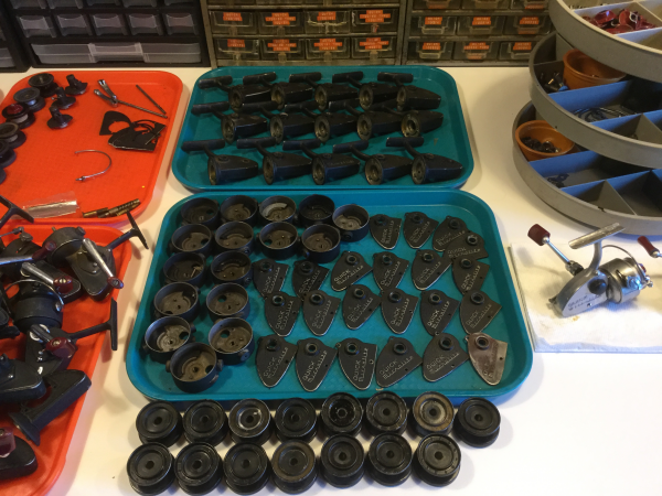

On those aluminum cranks with a steel pin, and 60 years on the clock — they are sometimes the toughest to extract.
I think that a press is the right way to go with the least chance for damage.
I have always used 1/16", 1/8", or 5/32" punches and a hammer, on these.
The crank is secured between the wooden jaws of a Jacobsen clamp, with a block of wood underneath drilled with a 1/4" pin escape hole.
The pins that are roll-pins, are much easier.
While doing (batch strip downs) full restorations on Microlites yesterday — ended up punching out 17 of these little suckers with aluminum cranks and steel pins — no issues.  Just make sure the pins are coming out backwards — and use a 16 oz hammer with a steady and solid "set" on the pin.
For smoothness, and to be good for another 30 years — Got to do a full disassemble — starting with the crank, then the gears and bearing removal — to get everything cleaned, evacuated of all old crud, burnished, polished, and lubed properly.
