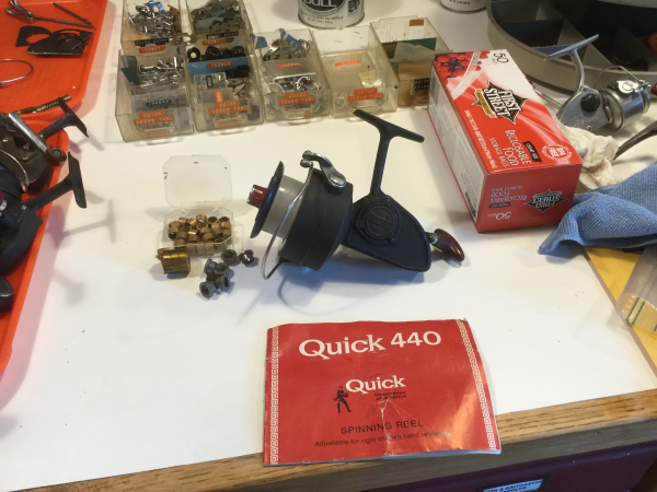

I'm fresh into these, but within 3-4 months I purchased a couple of dozen of 270's a few 275's and 5 nice size boxes of parts. I also have a couple of 550's but only two.
There are 4 types of spools that I've run into:
One piece aluminum with multiple drag washers
Two piece aluminum with 4 screws holding it together and one drag washer
Three piece aluminum with 8 screws holding it together and one drag washer
One piece plastic spool with multiple drag washers.
I believe these 4 spools are shared by both reels mentioned here.
Congrats on the part lot, Sal. Looks like you're set for awhile.  I think you Fred and a guy from Iowa have the Dam parts market cornered.  :o
