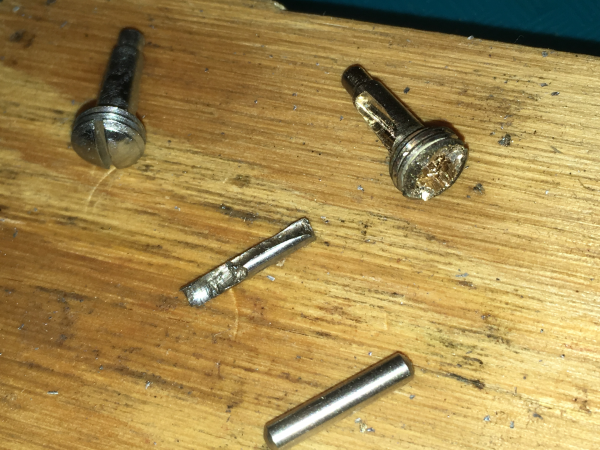

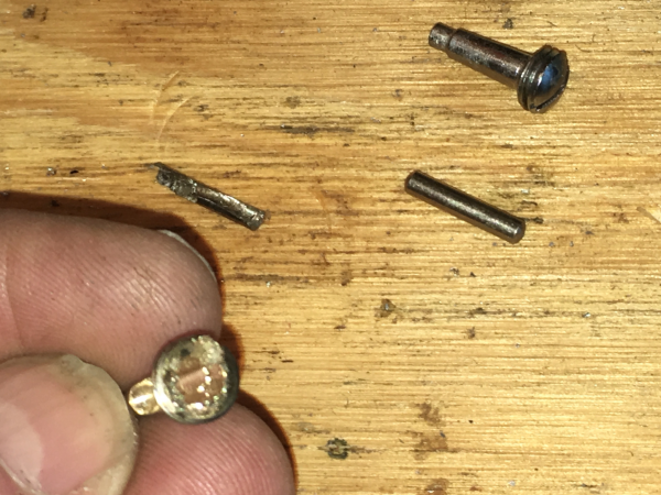

Spent 2 hours last night removing a crank handle keeper pin on a DAM Quick Super — plus a tapered stand keeper screw on the same reel.
Typically, they are seldom so hard — but when these are used in salt, or not serviced properly, the combination of aluminum alloy cranks and steel pins causes some sort of a chemical welding bond.
Soaked in Kroil for a couple of hours, then ended up saving the unreplaceable aluminum alloy crank by drilling out the screw and pin.
Still was touch and go...
In 40+ years, I have never lost a patient or gave up on any reel.  This came the closest though...
Broke a 1/16" punch, and (2) drill bits.

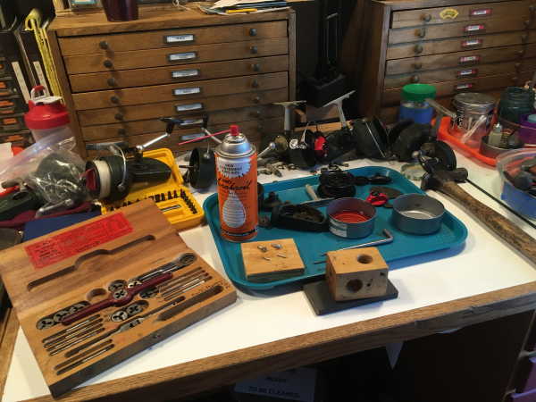

Leaning towards some kind of a hydraulic bearing press with a Jacob's chuck attached so that it would accept various punches.  Then I would use a cradle made from Oak to rest the crank, gears, axles into.
This may be overkill, and only needed a few times —but that sucker last night took 20 blows with a 16 oz. hammer — no movement in the slightest — just like trying to pound a punch through a 1/2" chunk of flat steel.  I think heat, Kroil, and a press with a custom jig may be the way to go.
